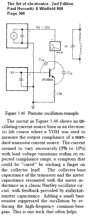

Well I tell a lie, there's an example in The Art of Electronics 2nd Edition but it's an accidental oscillator, see attached. :D
