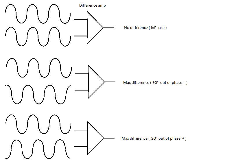

Just to cause a tiny bit more confusion.. Normally a half wave aerial or 1/4 wave aerial is used... Most transmissions can be recovered with the smaller aerials..
AM, as the animation shows, is the easiest to follow The amplitude of the signal controls the amplitude of the carrier... The FM is a bit more involved as the frequency can only shift a bit... I believe up to 90° up or down... If you lock on to the frequency, the phase shift from the norm is the signal amplitude.. A quadrature decoder is used to detect the phase shift.. This isn't my area of expertise and I'm sure others will help explain..
Actually when a carrier is FM modulated, the deviation can be very wide. The deviation is how far (in frequency) the carrier shifts and is directly proportional to the amplitude of the modulating signal.
How much deviation is used depends on the application and the system parameters.
Examples:
FM broadcasts in the 88 to 108MHz band have a system deviation of 75kHz and a maximum modulating frequency of 15kHz.
Using Carsons Rule, the bandwidth occupied will be 2 x (75 +15) = 160kHz.
FM transmitters for business use (taxis etc, 160 to 170 MHz ish) have a system channel spacing of 12.5kHz.
To avoid adjacent channel interference, the deviation is 2.5kHz and the maximum modulating frequency is 3kHz.
So, using Carsons rule the bandwidth will be 2 x (2.5 + 3) = 11kHz, which fits nicely within the system channel spacing.
Sounds like a form of Phase Shift Keying (PSK) for digital signals. Not a strong area of my knowledge.
