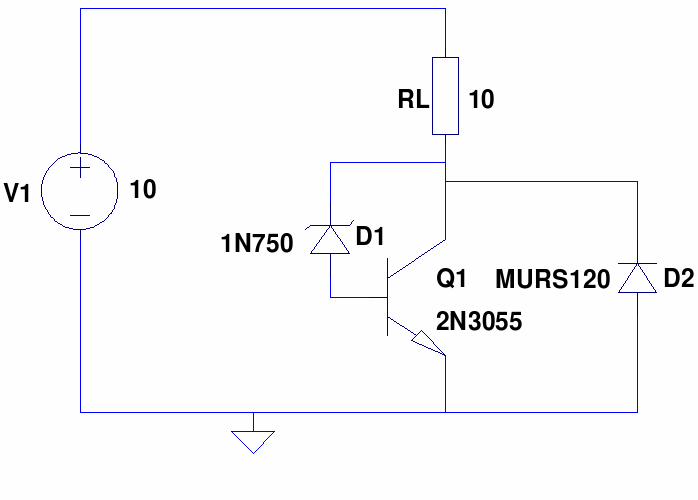

I see. I was curious because I had always wondered seeing as how I seem to have trouble finding zeners of sufficient current sometimes.
You can connect a diode to a large NPN transistor to increase its power rating and if you're worried about reverse current then connect a rectifier in reverse parallel.

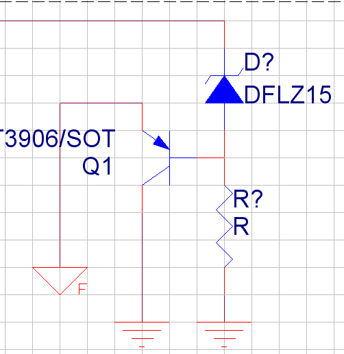

And if I wanted to provide a voltage that was ~15V whose upper reference was the supply voltage (rather than ~15V whose lower reference is the supply ground) then this would be the correct variation right?
(The white triangle would be the "floating" ground of the supply, ~15 below the supply voltage.)

You've confused me, where does the zener's cathode go?
This is what I'm talking about, the equivalent zener voltage will be Vbe greater than the zener - in this case it'll be 4.7 + 0.6V
You don't need to wory about a base resistor, the transistor will take as much as it needs to sustain the collector current and no more.

For my circuit:
THe zener's cathode goes to the positive supply AND is also the positive voltage terminal of the load. (I'm trying to make almost a negative supply, I guess, that's referenced to the +V of the source).
If I short the resistor...won't that short the zener to ground? If I just open the resistor, where does the base current go?

But I am trying to make the load voltage equal to that of the zener's breakdown. It seems that your circuit is dropping the the zener voltage across the NPN and the extra source voltage is being dropped across the across the load, isn't it? I need a regulated voltage that is connected to the high-side of the voltage supply- I think a PNP is needed for that. THe +V of the load is equal to the source's postive voltage, and the load's ground is sitting 15V below the +V of the source., with the extra source voltage being dropped somewhere between the load's negative terminal and the source's ground.
Doesn't your circuit also effectively form a series circuit with the NPN's BE diode, the zener diode, and the load, destroying the zener? I'm thinking the the NPN circuit model here. Or am I forgetting something where the collector current can also control the base current? My understanding right now is that the base current controls the collector current and it does not work the other way around.

Yes you have, the collector current does effect the base current in this circuit because the transistor actually diverts the current away from the base when the it turns on. If the transistor has an HFE of 10 and the current through RL is 1A, Ic will be 900mA and Ib will be 100mA.
Also, if you ignore RL for the moment, and just look at D1 and Q1 it doesn't matter whether you put RL on the high or low side providing the current is limited to a safe level.
