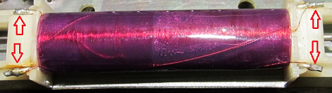

Hello. I'm trying to detect and fix boards of old turret lathe and components are from ~70's or so, made in west germany. I need help detecting this two components which i dont know exacly what they are and how to test them. This big component with metal protection (underneath is coil and inside is some kind of glas, 5-6 outs to pcb) and red component (i suppose its kind of varistor?) with 150/4 writen on it. Anyone have an idea what this is? Thanx

Thanx! Here is another picture, without cover. I checked diodes,resistor,caps,etc so far and everything is fine. Is it posible that this big component(transformer as u said) is fried or it is last to suspect? I have 4-5 boards of this machine, and there is probably ~8-10 of this components
What are symptoms (fault, what it should do, what it does)? dWhat equipment you have? (oscilloscope etc...) I personally don't suspect transformer, at least yet.
Also, that transformer looks like also, possible solenoid/relay? What is at the ends, like inside in that tube?
I just find out, its probably a reed relay. Looks similar to https://standexelectronics.com/wp-content/uploads/HI.png

DUH! How I forgot reed relay...

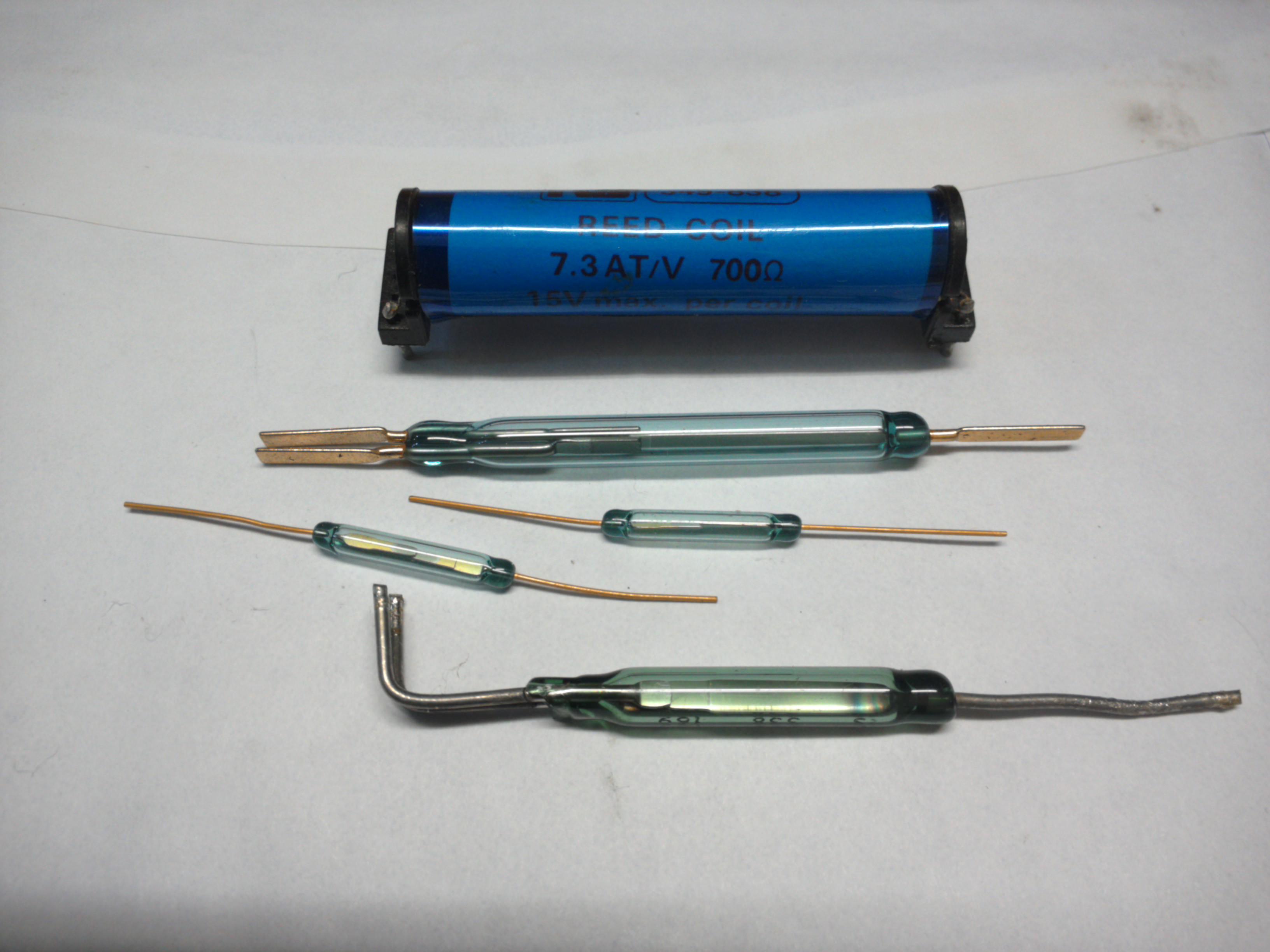

That is a reed switch / with operating coil.
The switch is a glass tube with 2 contacts in it which close when a magnetic field is present.
If you hold a magnet near the reed switch it should close.
These reed switches are also often used as door switches, in alarm systems.
These switches are only rated for a few mA's at the most.

Couple of reed switches and a coil I found in my workshop.

Odd that it has four terminals:
A SPDT reed switch? Or maybe a bipolar CT (is there such a thing?)?
Two for the coil and two for the reed switch?
Don't think so, that coil may have two windings maybe two imput sources.
The reed switch gets normally soldered at the end tails of the glass tube.
See picture in post 4.
