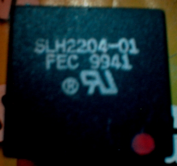

Sorry about the crappy photo, camera has been giving me trouble lately.
Was sorting out some salvaged parts, and couldn't find any info on this one.
Physically, it's about 1 inch square, about 1/2 inch tall. Red dot lower right hand corner. Four leads underneath, about the same diameter as a resistor, at each corner. Not entirely sure what sort of PCB it came off, maybe a satellite board. Leads seem a little thin for a bridge rectifier, maybe a relay...
DC-DC converter made in 41st week of 1999
Thanks. Might be a useful part. Wouldn't happen to know where I can get a data sheet? Wasn't able to even get a description. Got as far as Frontier Electronics Corp.
Not a very informative site. Think it's current production. I thought it might be a transformer by it's weight, just an odd package. Lots of Google hits, but only list the part number, no specs.
I've seen transformers and inductors in this sort of package before.
Have you measured the resistance between the pins?
It's quite easy to measure the coil inductances and turns ratio using a signal generator and oscilloscope.
Haven't attempted any measurements, but I'll go with the inductor, as it seems consistent with other parts made by the company. Got an inductance meter and will dig it out (been gathering dust for a few years..).

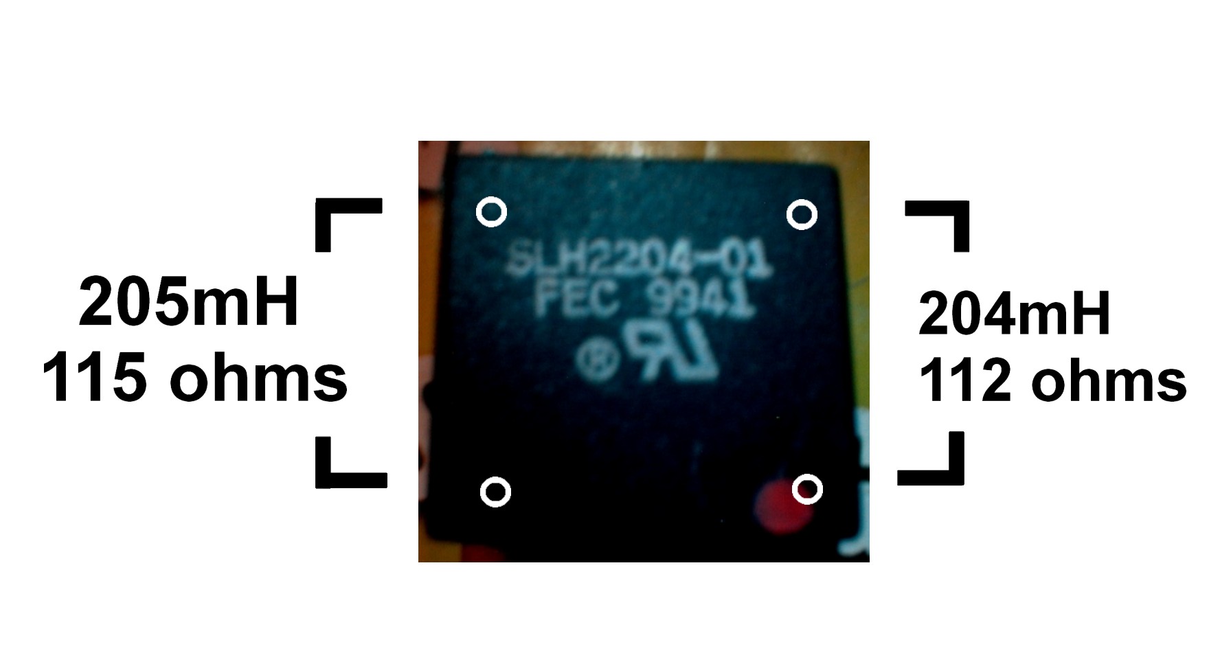

Did some measurements. Not a huge difference between primary and secondary.

How big is it?
It sounds like a pulse transformer to me.
I doubt it's obsolete, there's always a need for pulse transformers, opto isolators aren't always the best thing to use you knoe.
25mm square, by 13.44mm tall... Surprisingly close to my earlier guess. I've pretty much run out of places to find specs on these. Just caught my interest because it's packaged very well, and figure it must be a valuable part.
