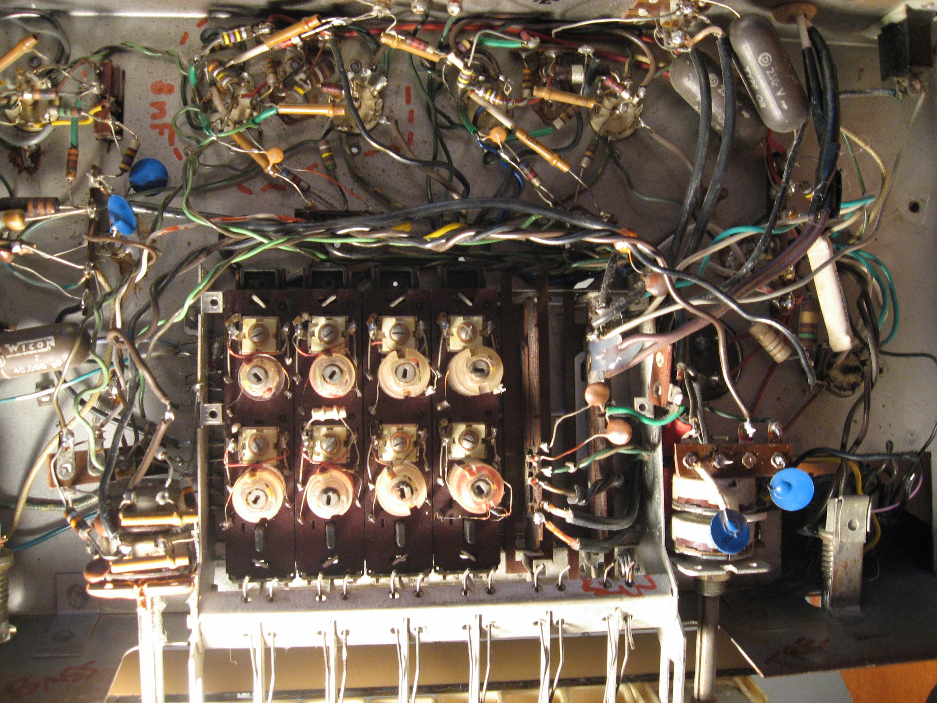

Hello!
This is my Grandfather's Mercury Stereophonic Tube Radio, circa 1960.
I don't know if that brand existed in other countries, I can't see any information on the net about it. The mode switch is labeled "Torotor", a Denmark brand, but nothing else.

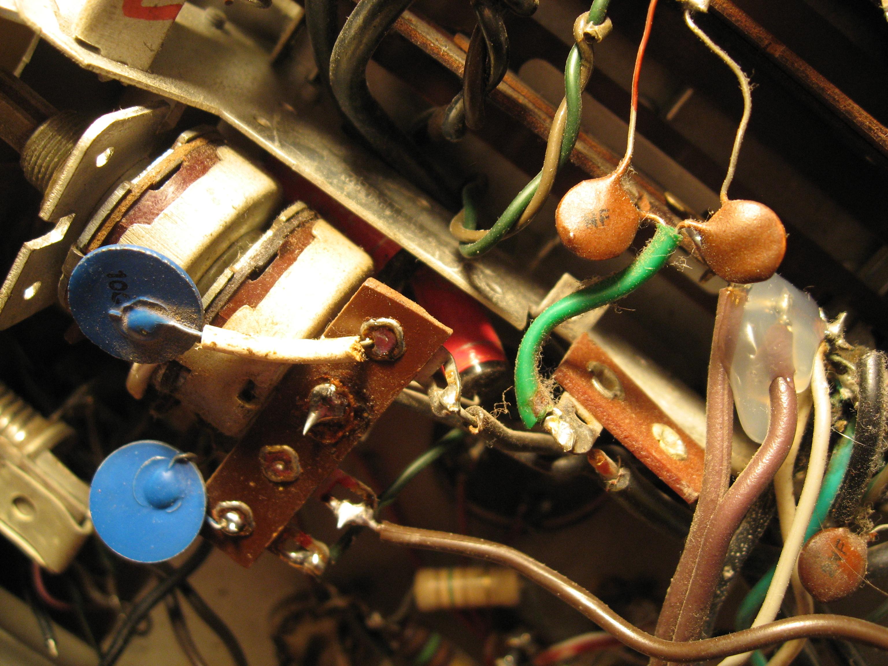

Ok, let's proceed with the real question. I'm replacing the old, dry components with new ones. What are the blue discs, in series with the potenciometer?
PS: Sorry, left knob is lost
PS: I stripped it from it's original huge wooden box (2 meters). Very sad, but I had no option

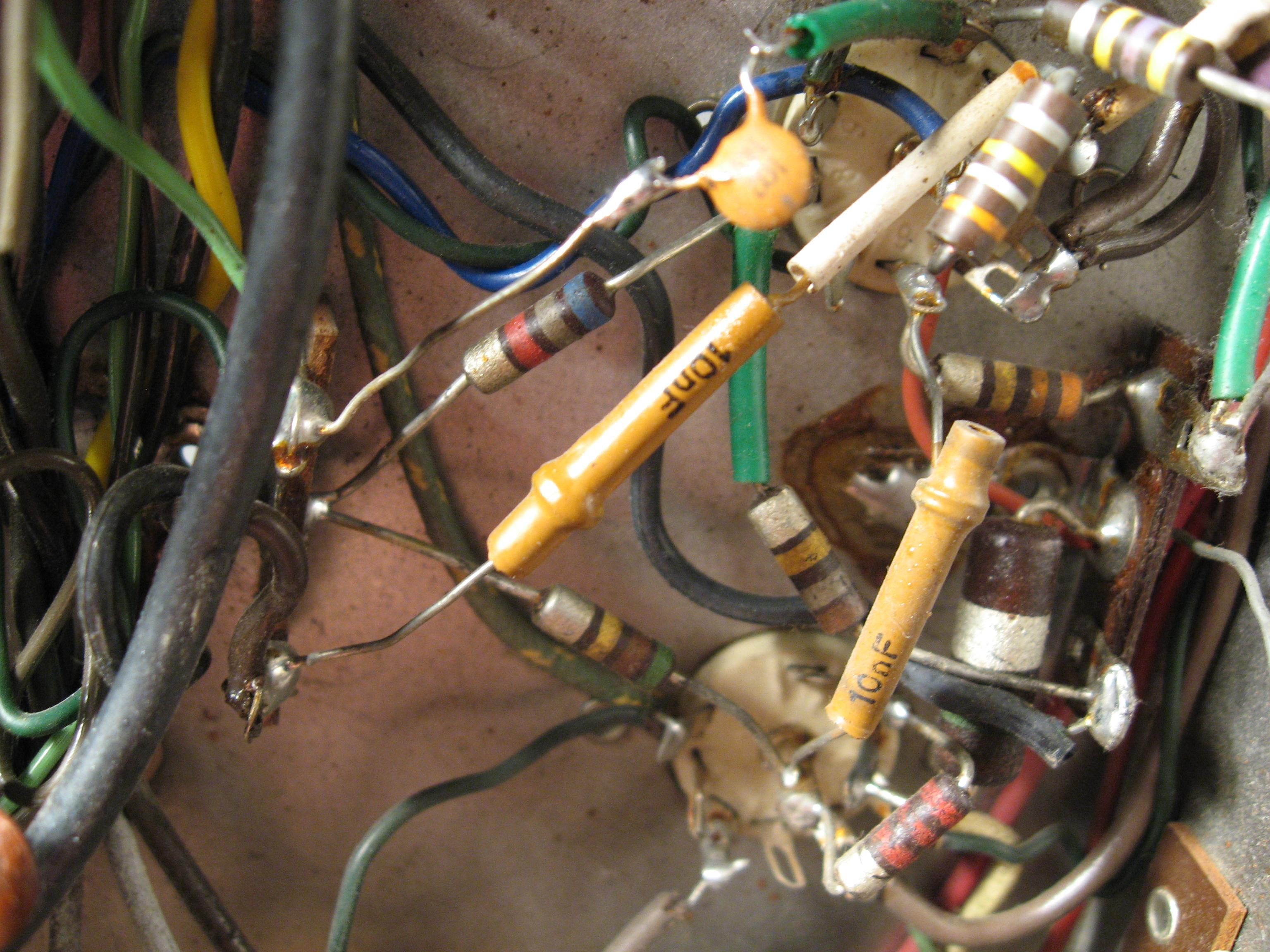

PS: Look those funny tubular 10 nF caps on the last picture!

Looks like NTCs or PTCs.
For final clarification remove one and measure its resistance applying heat.

But why are they installed at the volume potentiometers? Maybe to crank down the volume while tubes build up heat? EDIT: Forget it, that was a ridiculous guess
if you tell us to where they are connected with might be able to help
one end is on the pontensiometer...the other is where?
I think your guess wasn't as ridiculous as you assume. As the valves build up heat in the radio the pots (mostly carbon) might increase their resistance and using NTCs they compensate for resistance changes.

I wouldn't replace any of the capacitors unless they're electrolytics or paper dielectric types. Replacing the little ceramic caps in RF circuitry could set you up for a lot of alignment headaches -- or a non-working radio.
Replace resistors only if they're significantly out of tolerance or appear to be over-dissipated (over heated). Make sure the primary of the output transformer is good as a common problem in old tube radios was a leaky or shorted coupling capacitor that caused maximum plate current in the output tube(s) to burn out the primary.
Many radios of the era had their power switch mounted on the back of the volume control, making it an ideal place to mount an NTC..
Old caps
Hi, These are caps do not replace them unless faulty, they will last longer than you and I. Not like todays components they were build to last in them there days.
