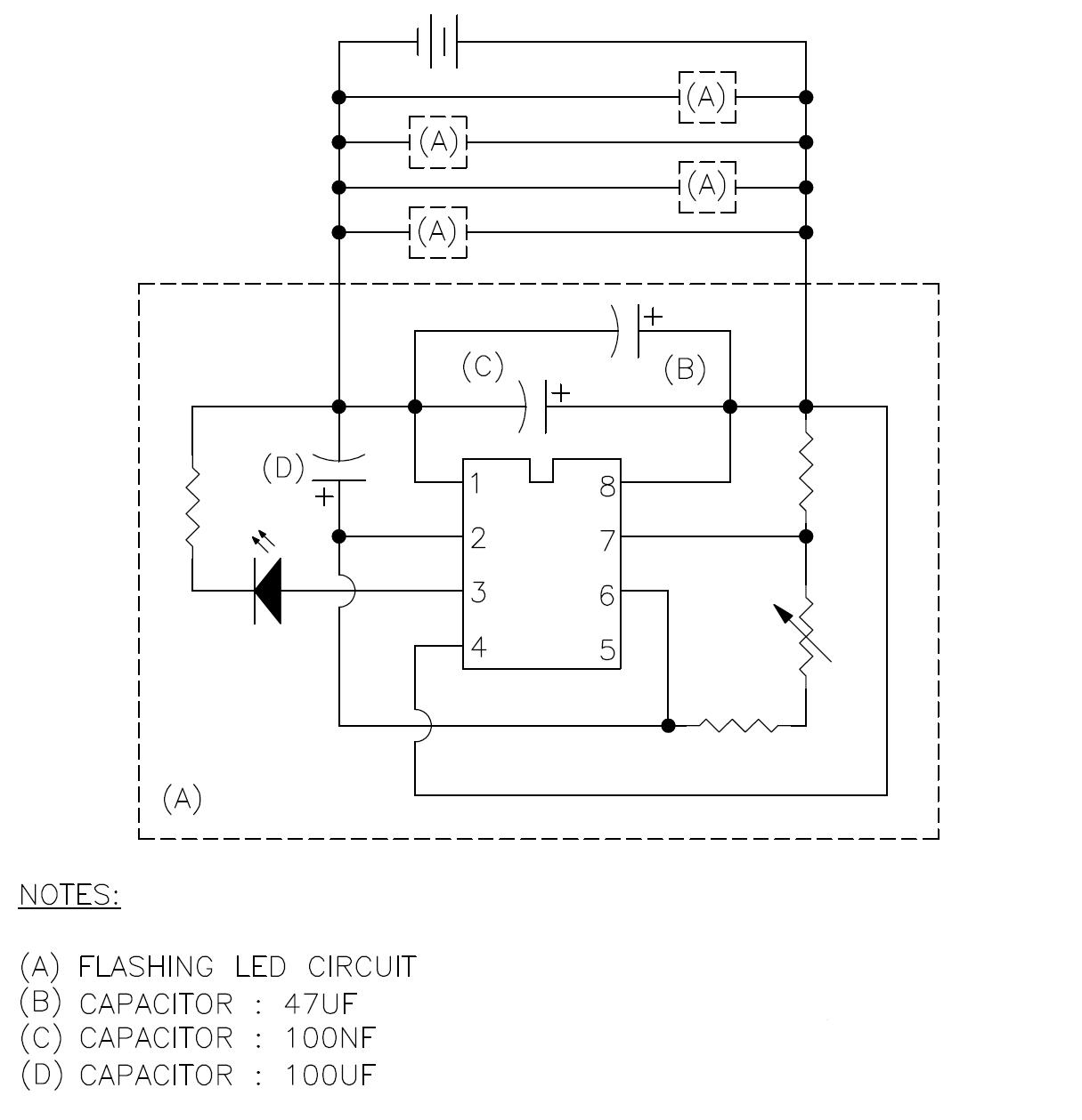

So I drew two drawings under the first instruction from email. One of them has the 47uf cap inside the individual led circuit and the other drawing it's outside. Im not sure which one is the way to do it since both have 47uf caps connected to 0V and +V.
Thanks for your help.

Pin 4 is normally tied to pin 8.
Then a .1 ufd. from pin 1 to 8 and a 47ufd. also from pin 1 to 8.
It is also good practice to add a .01ufd from pin 5 to ground. (pin1)
Pin 4 is minus reset. It (pin 4) is tied directly to pin 8 (positive supply).

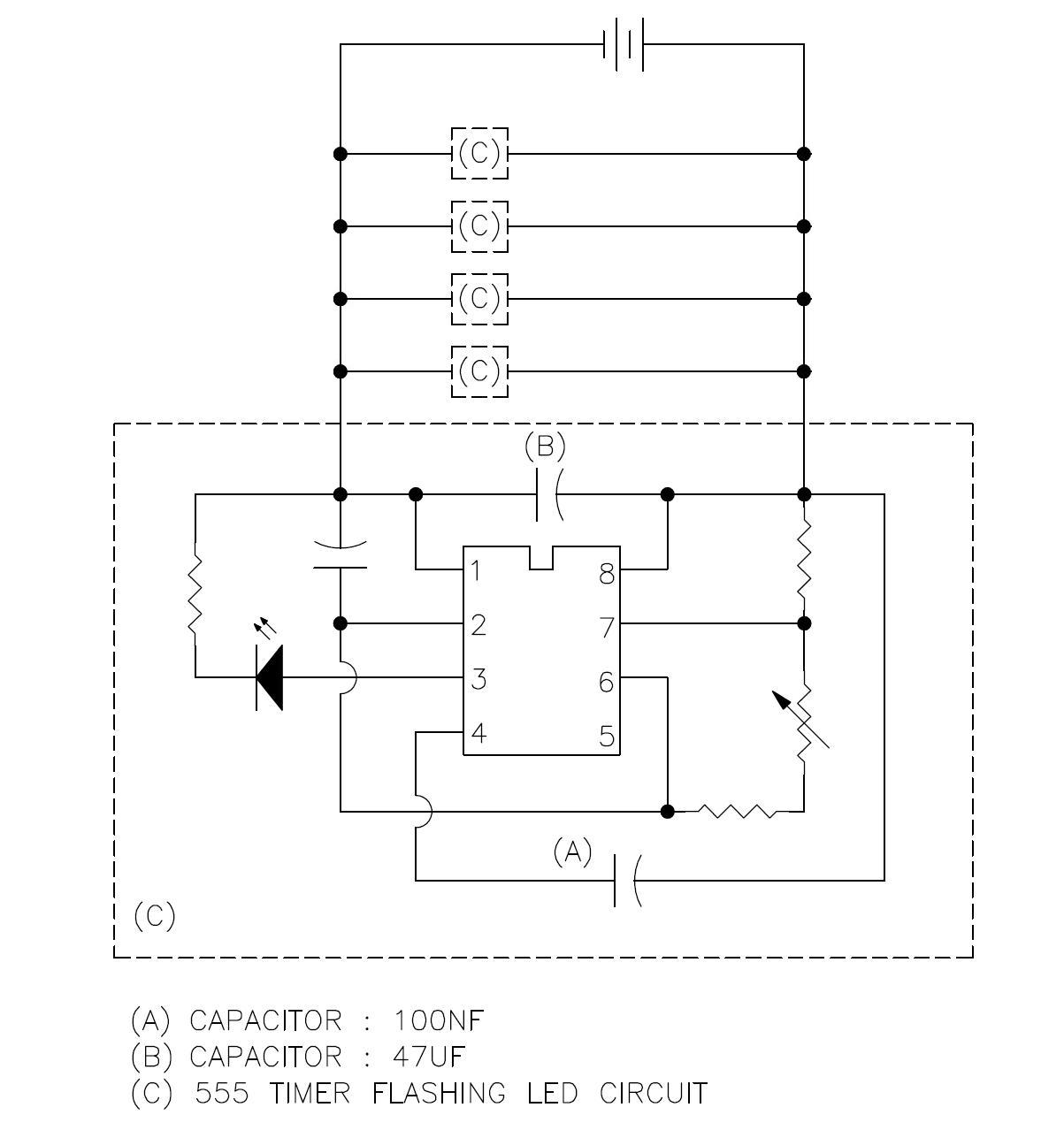

Here's what I have. (Attachment) I'm new to electrical forums where people ask for advice. So this is a big relief for me that I was able to find others who are willing to help who are knowlegable. I'll add a star to your reputation(s).

Your circuit looks OK,

You have four 0.1uF capacitors but only one is needed.
You have two 47uF capacitors but only one is needed.

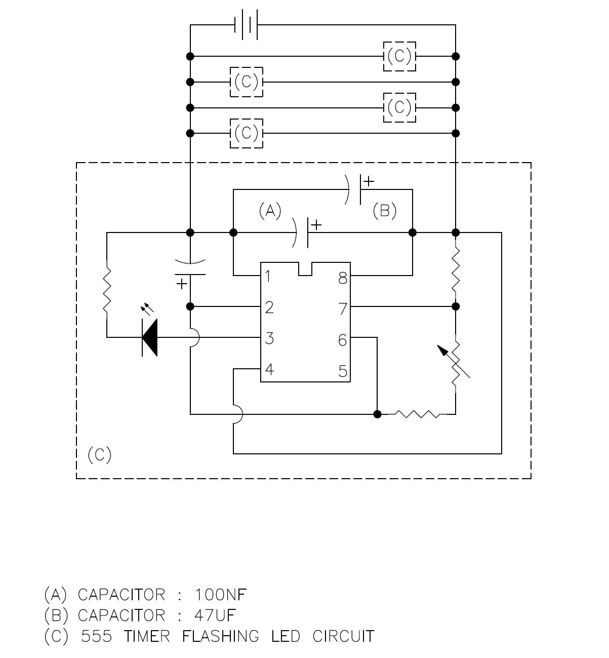

Audioguru: I'm posting the current up to date drawing. Within it are 5 caps of each type. There are 5 LEDs in parrallel listed under "(A)". You mentioned that only one 47uf and one 0.1uf is nessisary. Im not sure where they go. I would guess: around the battery. However I'm not sure.
Many Thanks.
Fit one 47uF and one 100nF capacitor across the +V and 0V of the supply, try the operation of the project.
If you experience problems due to 'noise' causing interactions between the 555's, fit a 100nF across pins 8 and pin 1 of each 555.
