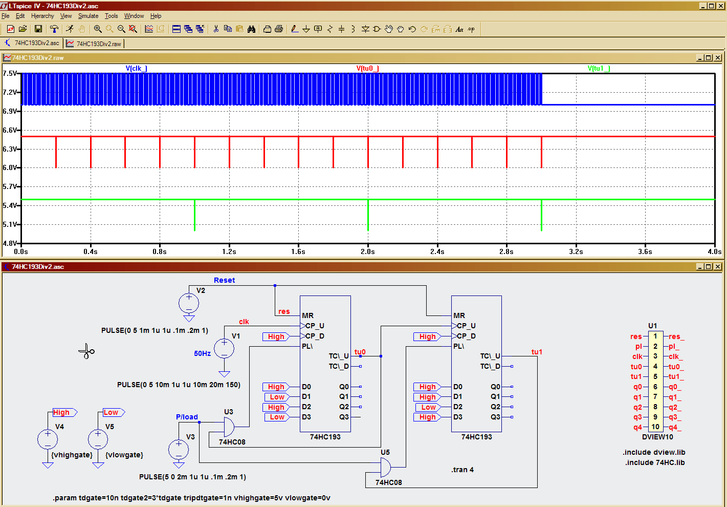

I have clock 50Hz, and i need 1 HZ using 74193,, can some 1 explain how ?

You will need two 74193's to get a DIVIDE by 50.
Do you have any NAND or AND gate IC's you can use with the 74193's.?
Must you use 74193's or can you use 7490's.??
yes i have NAND gates , but must use 74193 ... so the outpout from the AND gate that goes to MR is 1 Hz ??
OK,
The 74193 is a 4 stage Binary counter so that it divides by 16, what you need to do is divide the 50 by 10 in the first 74193, so thats 5 pulses/sec out and then divide the 5 pulses by 5 in the second 74193, that will give a 1 second pulse.
So the NAND gates are used to detect when the first 74193 has reached a count of 10,,, reset itself and clock the second 74193 on by one pulse.
In the second 74193 the NAND gates will have to detect when the count gets to 5,, reset itself and output a 1 second clock pulse.

it is not homework man ! it is possible question in my Exam 2morow. Any way, Eric answered my question .. SO dont bother yoursellf![]()
As it only a revision question, this a better solution.![]()
man i love your second solution,, it even made understand the parallel load Function.. ThQ. what is this program you used ?
