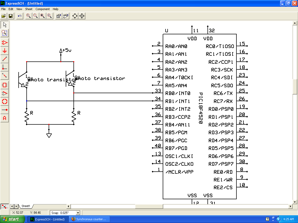

planning on using a disected mouse (wheel type) to determine wind directon using a PIC.
basically an up down counter.
starting with this code
Swordfish Wiki | SwordfishUser / DialEncoder browse
idea is to just use the two photo detectors and wheel (not wanting to unless necessary re engineer using the IC that is in the mouse. just the two detectors for the one wheel. (other wheel will be used for wind speed detection)
Thinking but I know its not right
if B0=1,1,0 and B1 = 0,1,0 then CW
if B1=1,1,0 and B0=0,1,0 then CCW
schemaic from another site
any suggestions?

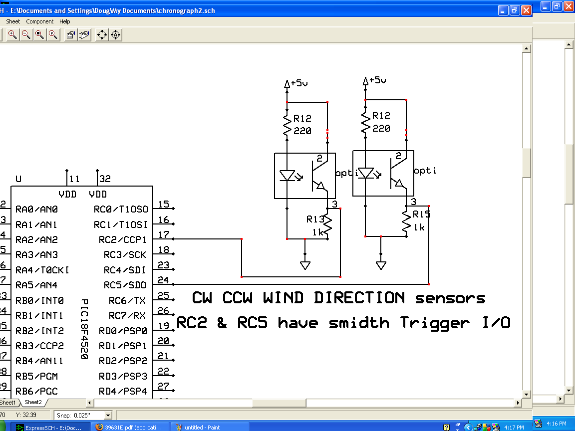

wind direction sensors
schematic of planned wind direction sensors using a mouse wheel and IR detectors (no IC from mouse)
using RC5 & ^ as they are schmidt trigger I/O ports (shouldn't need 74hc14?)
right way to go, I don't know??

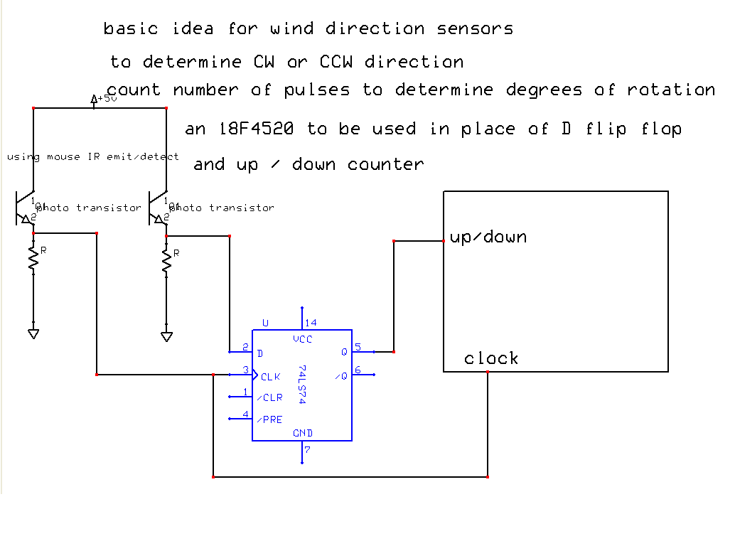

basic circuit idea
for determing CW or CCW direction then count degrees of rotation
weather this is doable?
Quadrature decoding for direction of rotation and count will work...but...how are you going to establish you initial direction? Maybe manually hold the wind vane, pointing north, and have a "set" button to zero your direction counter.
Ken
THATS exactly my plan
place behind the cannon in line with barrel aimed at target.
release the wind vane as it is locked until pointed at target (reference point)

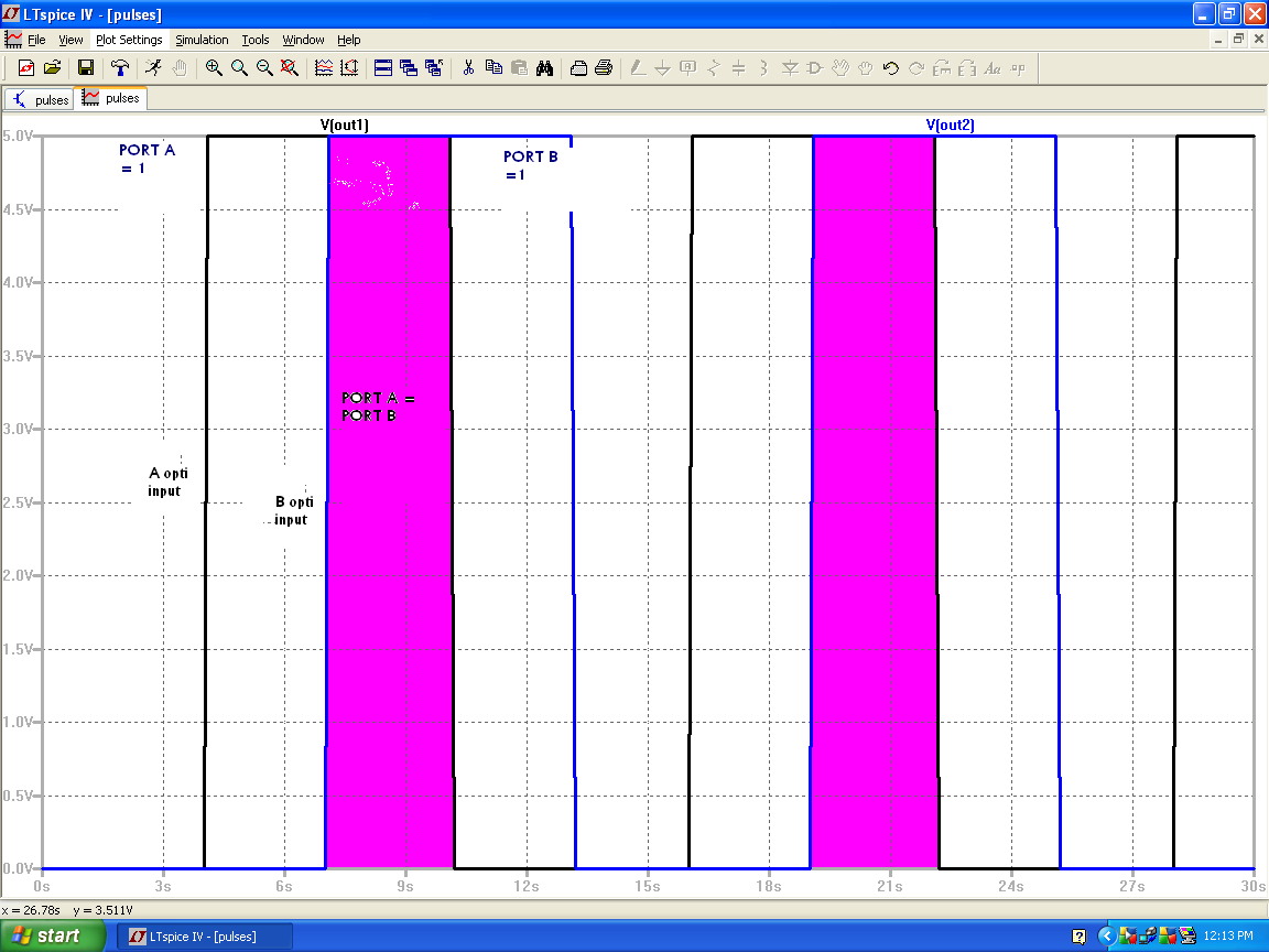

have2 data lines input to PIC
have interrupt at rising edge of say A input
in interrupt handler check state of B input
thought about adding IF A = B --but I only need to count the rising edge of one input until goes high again.
my recvised code. I know it isn't right but I am trying. one of them learn by doing kinda people.
Port B0=A        //A input
Port B1=B    //B input
While true
      A =1and B=0
      until A=0 and B=1
      CW=CW+1
end
While true
      A =0and B=1
      until A=1 and B=0
      CCW=CCW+1
end
// add if A = B then return to the first WHILE TRUE routine??
Ken
I would put a 3rd optical sensor on the rotor, so it triggers at only one posiiton in a rotation (say North) and just use that to reset the count. The mouse has 4 sensors in it so he has a spare couple of opto sensors.
