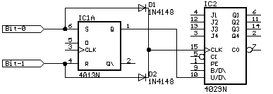

yes, i know the 74192 and 193 but they are hard to find here and quite expensive, so i have an idea.
if i could take the 2 bits and use a flip flop with set and reset so that one bit sets it so i have Q=h wich will count up and in the same time the bit is sent to the clock input of a 4029. when the other bit is H then i have a reset and i got Q=L so it will count down
here is what i mean, do you think it function?
or i will need some delay so that first it is set wich direction it will count and then it will get the pulse?i cant upload here so i will up load to electronics ideas.....
here is what i think of.....

Hi Bogdan,
No, you're not alone. Jobs that pay - and celebrations - have to come first.
The circuit will work if you tie the S & R inputs to gnd via a suitable resistor.
If you look at the truth table for the 4013 you will notice that pin 1 is the opposite of the R input and that pin 2 is the same. This would allow you to control count direction with one bit.
If the 40193 is similar to the 40192 - no datasheet handy - then it should be ok.

i am not sure i understand _ what you want to suggest?
i know i can conect Din to Q and create a toggle flip flop, so i have one bit for the clock and one for the direction.....
i think that this will work too, but it will be a bit harder to control what i want trough software.....
i dont need to put the resistors from R ans S to Gnd because when the bits are not 1 they are 0 not opened, so i dont see the need for these resistors...
