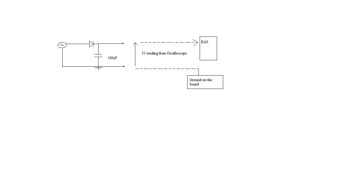

Can you show your schematic? 1 V across the diode will drop become 0.3 V. Half wave filtering the 0.3 V will become almost nothing IMO.
Thanks for your replies.
I am using a germanium diode which has a drop of .3 V and the voltage of my signal before rectification is 1.3. Thus 1V pk signal to the PIC.
For potentiometer at 1V how many leds you can see on PORTC?
I am getting the value 51 in binary on the LEDs [using a potentiometer] but am getting 255 [i.e. 5V] when I apply the same pk 1V signal which is rectified and converted to DC. I am all confused about this.

What is the voltage on the pin with the signal connected? This should be the voltage across your capacitor. If this isn't 1V then we need to see the circuit between your AC signal and the pin.
Dear Mike,
I have attached a schematic of my AC to DC circuitry. I measured the voltage across the capacitor using a oscilloscope. The voltage measured was 1V.
Many thanks
This makes no sense. If you put a variable voltage on the pin it works correctly but if you put a fixed 1V on the pin it reads as though 5V is on it.:confused:

Hi all,
Mike- I figured out the problem. There was something wrong in the oscilloscope's reading [Finally my lab technician has fixed it :)].
The code seems to be working fine. When I increase the amplitude of the signal, the corresponding values at PORTC appear to be correct. The only weird thing is that when I increase the input magnitude from 1 to 5 V, sometimes the values are totally wrong. I am assuming that it has something to do with the capacitor and its charging and discharging properties :confused: .
In my circuit, one end of the capacitor is connected to ground and the other end to the PIC [RA0]. Could you please advise if I need some changes in the AC to DC circuitry to overcome this last problem?
Many many thanks in advance.
Vili
Your 100uF capacitor is rather large. It may be taking time to charge from your signal. Try changing it for a 1uF. Once charged your capacitor need someway to discharge, try putting a 100k resistor across it. This will allow fast charging and slow discharge. You could also try 0.1uF and 1M but this may be too low for the Pic.
