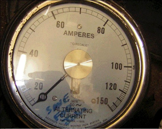

The CTs and the meters usually come as a set, but they don't have to.
I assume the analogue indicators are meters.
If the meters are for use with a CT then there should be an indication
around FSD of the CT output current, which should be marked on the CT.
On this meter there is a little tiny '5' marked discretely on the
outer edge, just by the '100' mark.
That is because this meter is for a CT output of 5 Amps at its
intended high reading, when its primary current carrying conductor is
passing 100 Amperes.
Accordingly the meter or meters to be used with this CT would be bench
set to read in that position with 5 Amperes going through the meter.
This would be adjusted by shunts within the meter itself, not
externally. Externally the meters would just be wired in series with
each other, across the CT terminals. Some meters may be quite a way
off, and the instrument mechanic should be made aware of the dangers
and should take precautions as necessary.
So:
The meters are wired in series, the current through each is the same.
( for the given CT )
I hope this helps, but it is difficult to follow your request.
Best of luck with your arrangement, John :)
