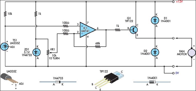

Please help me understand the following circuit. Please explain the working of the following circuit soon. I want to know why the diodes and the transistor is used.

The transistor amplifiers current. If the motor runs at 1 amp, this current is too much for the op-amp. The transistor might have a gain of 100 so the input of the transistor will be 0.01 amps to control the motor.
The diodes are used to protect the transistor. A motor can work as a generator and push power back into the transistor. (during braking)
ZD1 provides a stable reference voltage of 5.1V, TS1 produces a voltage proportional to the temperature. The transistor amplifies/buffers the current to the fan. D1 & D2 provide transient suppression of the back-EMF produced by the fan.
If the fan uses coils & a commutator, the voltage on the coils will spike every time the current through them stops. The diodes provide a path for the current of these spikes to flow through, instead of through the output transistor (which may damage it).
Maybe the transistor will die, maybe it won't
Most probably. The ones that don't are brushless dc fans (e.g. a PC fan). Do you not have any diodes? They're pretty cheap. Alternately you can use a resistor & capacitor (or even just a capacitor) as a snubber across the fan to try to suppress the glitches.
There's 2 diodes to account for current spikes in any direction. The top one is for current feeding back out of the motor, the lower for current into the motor.
