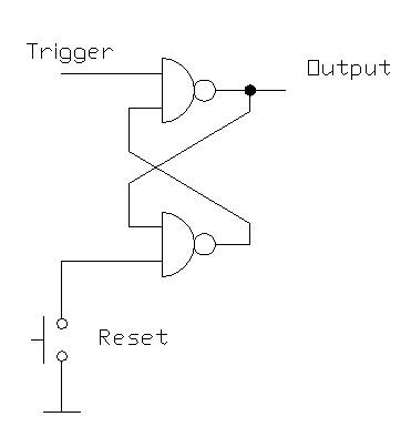

how about 74LS00? you can add pull up resistors to both inputs
if you experience noise problems (2x 1k will do).
Yeah, I was going to suggest that too. The only caveat is that the trigger input needs to be high when reset is applied. If the trigger is a level instead of a pulse, a differentiator would be needed on the trigger input. This is not necessary with the 74LS73.

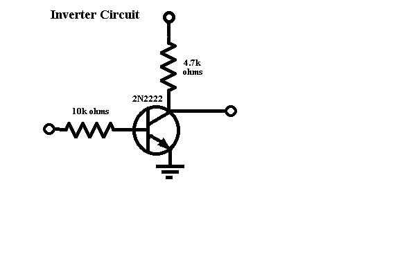

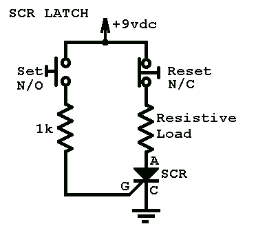

How about this Circuit?
Input can be from 5v to 9v and the output is reverse of the input.
Add that to an SCR circuit and you have it.
