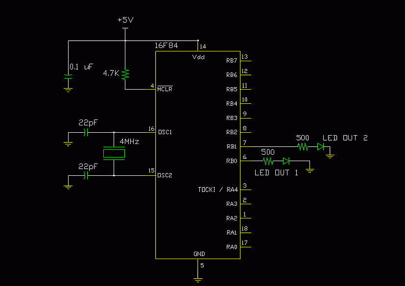

Cheers for your help but it didn't seem to work. I may have a problem with the practical circuit. Have you any suggestions of any circuit diagrams.
Cheers
Matt
How did you connect the PIC and which PIC are you using? Here is a schematic of what the circuit should look like:
