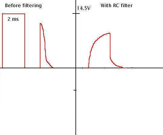

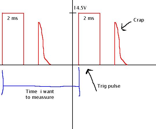

The PIC is going to meassure the time between the two "trig pulses" but i have a "crap" that is disturbing. I suppose i could get rid of it with a RC Filter, but I am so terribly bad at analog electronics.
I suppose that the 2ms pulse will look like the pulse in signal2.jpg when using a RC filter.
But that's no problem. So i just want to get rid of the crap so there is just free space between the two trig pulses!

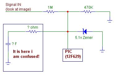

How do i figure out what values i need for this on the resistor and on the capacitor.
And what kind of capacitor should I use? A electrolyt or something else?
Please tell me if you see something else in the scematic that is not needed or used wrong.
I can also tell that this signal comes from a motorcycle tachometer, and this circuit will be used as a shiftlight.
The time between the two pulses differs so much so i can't just set a minimum time(in software) to ignore the "crap pulse", because at high RPM the time between the 2ms pulses will be very small!

I don't see any way you could use a simple filter to remove the second pulse, it would also remove the first pulse. Although you could try filtering it and using a comparator to detect signals above a certain level - but the wide variations in frequency are likely to mess up any filtering.
For a start though, why have you got this second pulse? - presumably you have a fault somewhere? - what type of sensor are you using?.
If you can't repair the sensor, you could do it in software, you don't need to set a minimum time, simply ignore every second pulse. As you're timing from rising edge to rising edge, it doesn't even matter if you use the good pulses or the bad pulses, the time should still be the same.
So simply detect a leading edge, start your counter, wait for the next leading edge, but leave your counter running, then wait for the next leading edge - where you stop your counter, giving the time you're looking for.

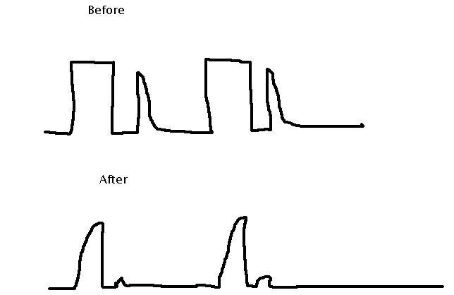

I thought that if i made a filter that filter the first ms of the pulses, then the crap would dissapear because that pulse is just 0.5-1 ms. The 2ms pulse would then just become 1 ms, but that would not matter. Is my theory possible?
You are so right about this, this is probably the easyest way to do it!
There is a problem with this method though. Because when i rev it really much the crap signal comes to close to the trig pulse to it dissapears. So then i just have 1 pulse.

I don't understand why this would not be possible?
I think the picture says what i mean. I don't mean that i want to filter away the crap and keep the trig pulse. I mean i will filter both, but the trig pulse will still work as a trigpulse because it is longer and will survive the filtering.
Isn't that possible?
I mean if i have the correct value of a cap and the resistor, i thought it would be possible to time it so that it will kill the first ms of all pulses, which would mean that the second would dissapear because it is just 0.5 ms long.

I don't think it would be possible, also don't forget - a filter will only work at one specific frequency - your application is a long way from one frequency!.

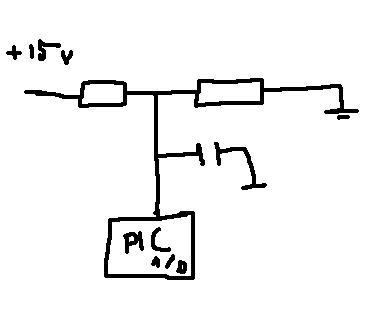

Maybe i should try the method of connect a large cap and use a 12F675 with A/D instead. How do i connect that cap then? Do i need a resistor then? Can you please make a easy drawing.

There is a simple solution. Just take the pulse (with no filtering) to a PIC input. Start a timer when the rising edge of the incoming pulse arrives.
Continue to monitor that the pulse is present for 1.9mS. If it is, then the pulse is valid and you can record it. If not, reject it. Wait for the pulse to go low before repeating the cycle.
Yeah, that would probably work. I'll try that.
