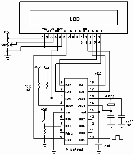

i would like ot use the counter function in the PIC but dont know how.can anyone show me how,preferrable in BASIC?i need it really really urgent.
the counter will receceive square pulses for 5 seconds and then reset again, then the PIC will do calculation based on formula and send to LCD.

no.the frequency may not fixed.actually i want to build a wind speed meter based on the slot disc cutting the IR beam. the PIC will receive pulses for 5 seconds and determine how many pulses have received.then it performs calculation to determine the actually speed in km/h. after receiving pulses for 5 seconds, it will reset.and how to reset it, i dont know.can anyone guide me?
i found in PICBsic Pro compiler programming manual that there is a command called 'COUNT' which counts the pulses occured on a pin for certain period of time.is it suitable for my project?
i couldnt find more detail about this type of counter on the internet and my knowledge in assembly language is poor.can anyone guide me in PIC BASIC language?

the setup would probably look like this,since i dont know which pin i should send in the pulses, so i assume it is on RB4.may b u can help me to correct it and decide which pin is more suitable.there is a switch connected to RB1.(this may also change if u feel that it has connected wrongly)
when the switch is pressed, the PIC will start to count the square pulses coming in for duration of 5 seconds and then reset. the fromula is:
speed = how many counts in 5 seconds x 0.006 / (1.39x10 power -3)
each time the switch is pressed, there will b only one reading on the LCD.i dont want make it continuosly showing different readings and i only want it to show reading each time the switch is pressed.therefore no looping in the program. that means each time the switch is pressed, the user needs to wait for 5 seconds to know the speed. the LCD module is hitachi 44780 based.

I belive your problem will not be on how to count the pulses in 5 seconds but more how you are going to be able to use your formula.
PIC are not good number crunchers.... PIC stands for Periperal Interface Controller..... and although it has math capability, it does not like floating point :shock: You are going to have to come with a way to use floating numbers, the easiest way is to deal with instead of 3.45 work with 345.

A simple loop that checks RB0 will do the trick. Something like:
Loop:
If PortB.0 = 1 then
  Count = Count + 1
end if
If TimeisUp = X then ExitLoop
goto Loop.
It will do it fast enough that it would be difficult to miss a pulse. You can use the interrupt on the RB0 to make it more reliable.
To keep track of how long you do this, you set a timer and count how many times it overflows. You can calculate how many overflows have to occur to have 5 seconds.
Check out timers and interrupts tutorials.
Also you should think on having your equation look more like:
Speed = (#pulses in 5 sec) * 431
that is 100 ( 0.006/1.39E-3) = 431
And when it is time to display just break up the number.
