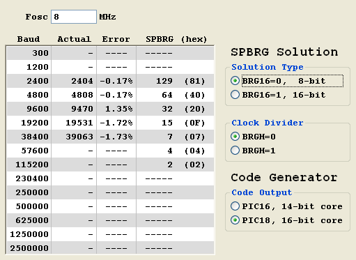

Hey all I seem to be having some trouble with this dag USART on my 18f2525.
Im trying to run it at: 2400bps from 8mhz internal
I just cant get the math right for the code i think.
To calculate i did:
((FOSC/BAUD)/64)-1
so thats
((8000000/2400)/64)-1 = 51.08 = 51
To calculate actual baud from above:
8000000/(64(51+1)) = 2403
Percentage:
(2403-2400)/2400 = 0.00125%
Which i assume is great!
The code im using is:
    OpenUSART(  USART_TX_INT_OFF  &
                USART_RX_INT_OFF  &
                USART_ASYNCH_MODE &
                USART_EIGHT_BIT   &
                USART_CONT_RX     &
                USART_BRGH_LOW,51);
The issue is i can get data 1 time and when i try to get more info i doesnt work.

As mentioned i can read 1 card then it seems to get suck on the built in function "DataRdyUSART".
Any thoughts?

It may just be me but that generator doesnt seem to help me. I tried the below image and using the BRGH and SPBRG and it doesnt work at all. Any thoughts?
usart-png.25130

Hi Jason;
You need to check for overrun and / or framing errors, which is most likely the cause of your problems (I recently went through the same thing).
I don't have any asm (handy) for you, but I see you know you're C18, so this should help.

Thanks for the info. I checked the RCSTA reg and its a "OERR: Overrun Error bit" issue so far I will implement the code above
The RCSTAbits.FERR part in your code is the same whether the error has occurred or not.
It says to clear it by reading the RCREG and then getting next byte. so maybe :

With your code and some C18 built in stuff i made the below code. But it still gets stuck.

Ok so far this seems to be working. If it fails ill be mad :( lol
