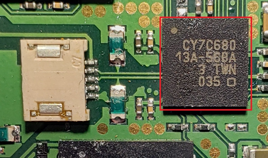

Does any have any insight on how to accomplish this? The chip in question is CY7C68013A-56BAXC and it's a BGA. Do they make BGA cloning devices like they have for normal DIPS? Attached is a pic of the chip in the circuit and I believe it is what is causing the NO POWER issues in these devices. Also, if the chip is protected, is there a way around that?

What is the device?
What did the manufacturer say?
Certainly no straightforward way. If there were, there'd be little point in protecting the firmware.
Welcome, I'm in agreement with Alex and would go a little further and say it'll be almost impossible to clone that chip. I don't know what DIPs you cloned but most modern DIP microcontrollers can't be cloned.

The circuitry you are seeing is for an intra-oral dental sensor (takes images of your teeth) and my company repairs these as well as cameras. No manufacturer is going to give me schematics or programming info for any of it, so we essentially have to reverse engineer these things to fix issues at component level. This is currently one of my roadblocks for power issues in these devices.
