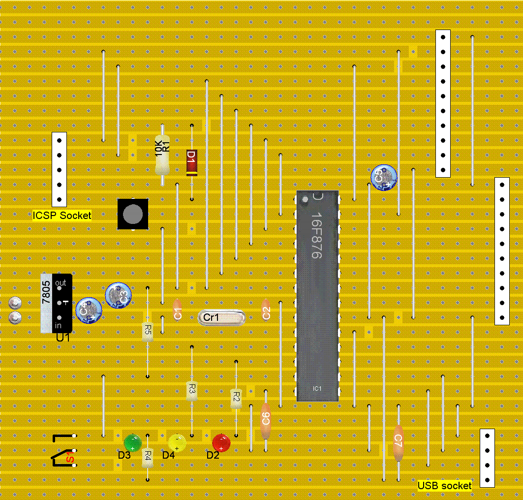

Buy the PICkit 2 and then build a UBW. It only takes a circuit board, a PIC and socket, crystal+caps, a few push buttons and LEDs, 3 other capacitors, a few resistors and a USB socket. I've put one together for about $8 using strip board. Of course, my home built UBW isn't as polished looking as the $25 one that you buy from Sparkfun, but it works.
With a PICkit 2 you can program just about any PIC, which is a needed capability if you are going to continue with PICs.
I've recently built a UBW type board, based on my existing tutorial boards, here's the beta layout - might be a tweaking done yet.
Just noticed - I haven't even changed the number on the chip :D
