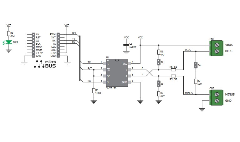

Hello guys,
I would like to make a communication cable to connect to a VFD and had a look at the instruction of the one they're selling. (See attachment)
It shows that conductor #4 has a pullup resistor and #5 a pulldown resistor. Does that mean I connect the pullup to #4 and #7 and pulldown to #5 and #8?
Kal
  • BBV28000_00.pdf
Yes... BUT!! If there is only one RS485 unit, you will need the 120 ohm terminating resistors aswell
Look at the interface... J4 is for "End of Bus"...
