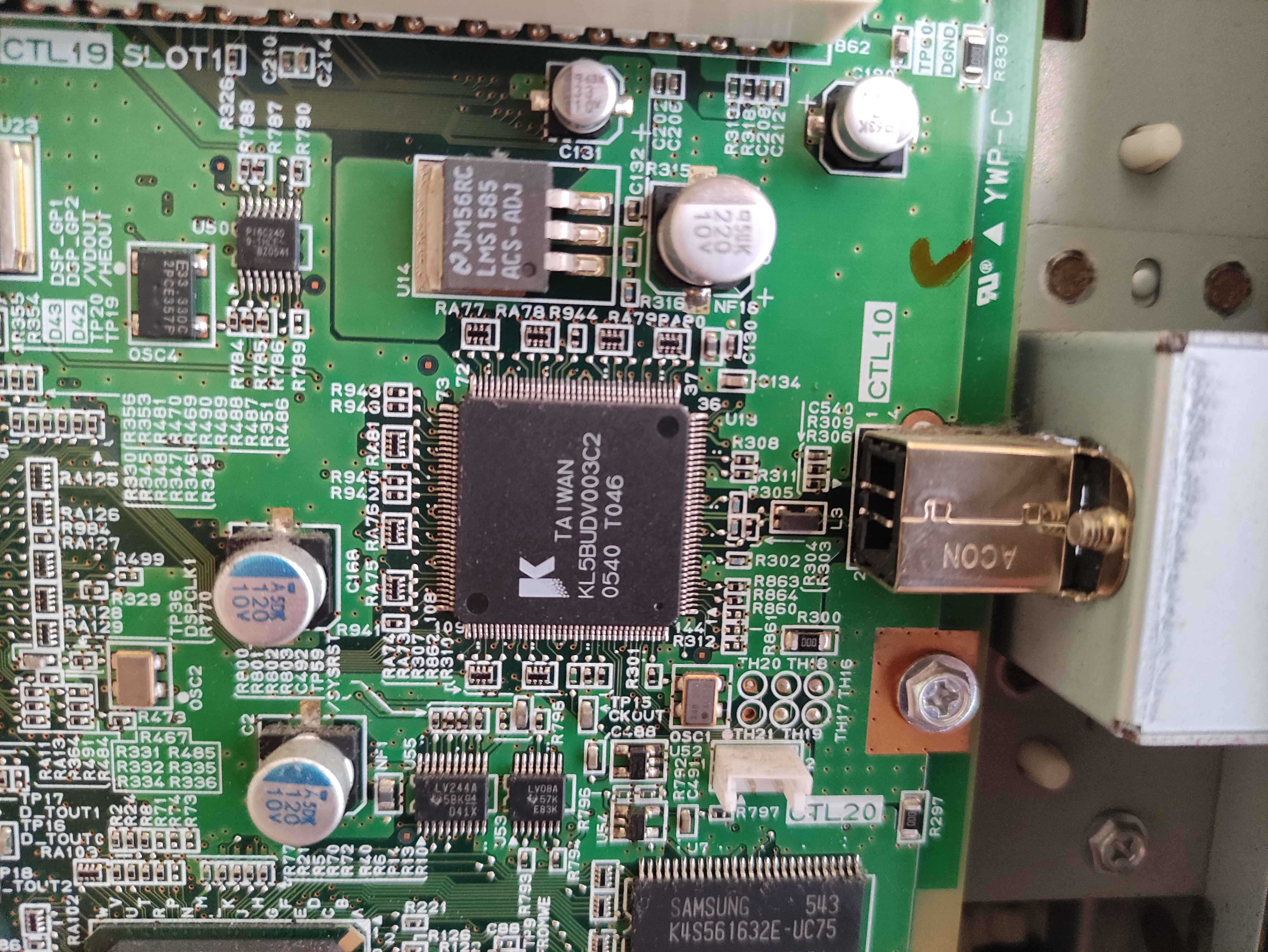

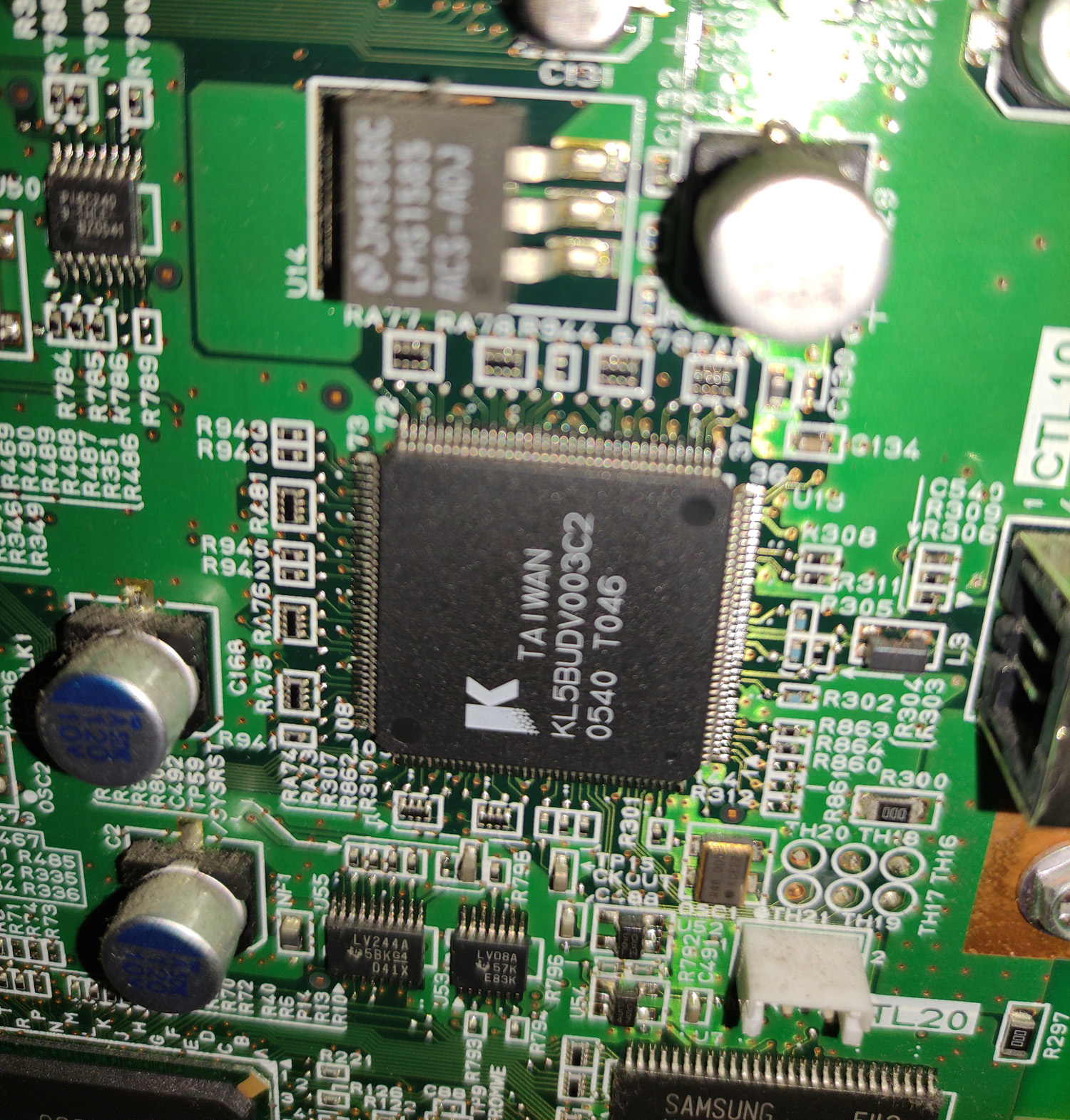

I have a ~20 years old professional film photography scanner manufactured by Fujifilm. Fujifilm produced a few units of this scanner worldwide, and today they are completely discontinued.
Since few days ago I’m facing a critical issue with its high-speed USB 2.0 connection. Basically its USB device is not detected by the host.
![datasheetspdf.com](https://semiconductors.es/pdfhtml/0269/569024/page-000001.png)

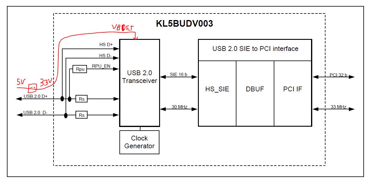

KL5BUDV003 datasheet
KL5BUDV003 - The Kawasaki KL5KBUDV003 is a high performance device that transfers data between the USB2.0 high-speed BUS and the PCI 33MHz, 32 bit BUS. This 1 .

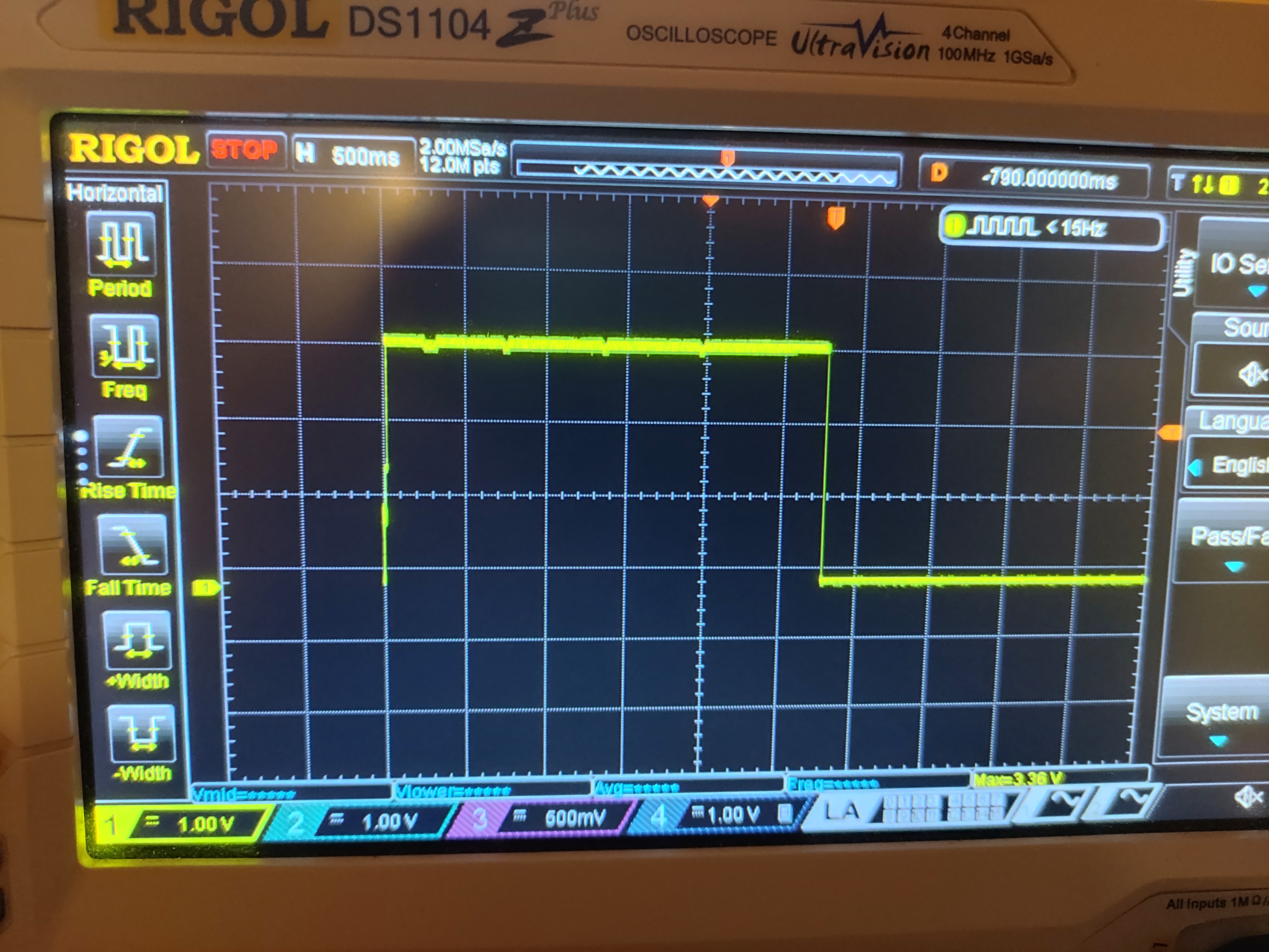

I have checked all DC voltages and clocks applied to this device and everything seems to be ok in the PCB.
Then, using an oscilloscope, I have sampled the D+ and D- lines, RPU_ENA and VBDET pins.

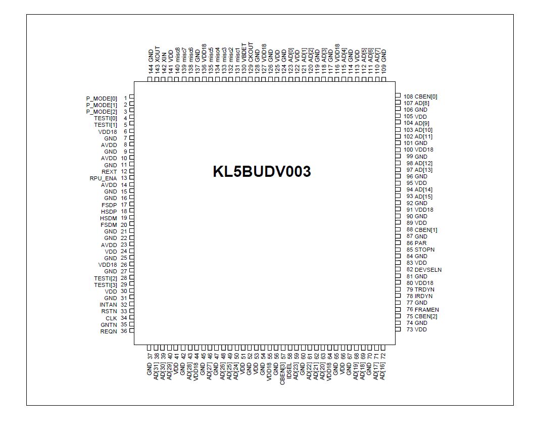

- RPU_ENA: This pin is used to indicate a high-speed USB connection to the host. The host recognizes a new USB device only if this pin is 3V (pull-up to the D+ line)
- VBDET: Pin indicating that a host is connected (based on the 5V USB power supply)
- D+ and D- lines: USB data lines

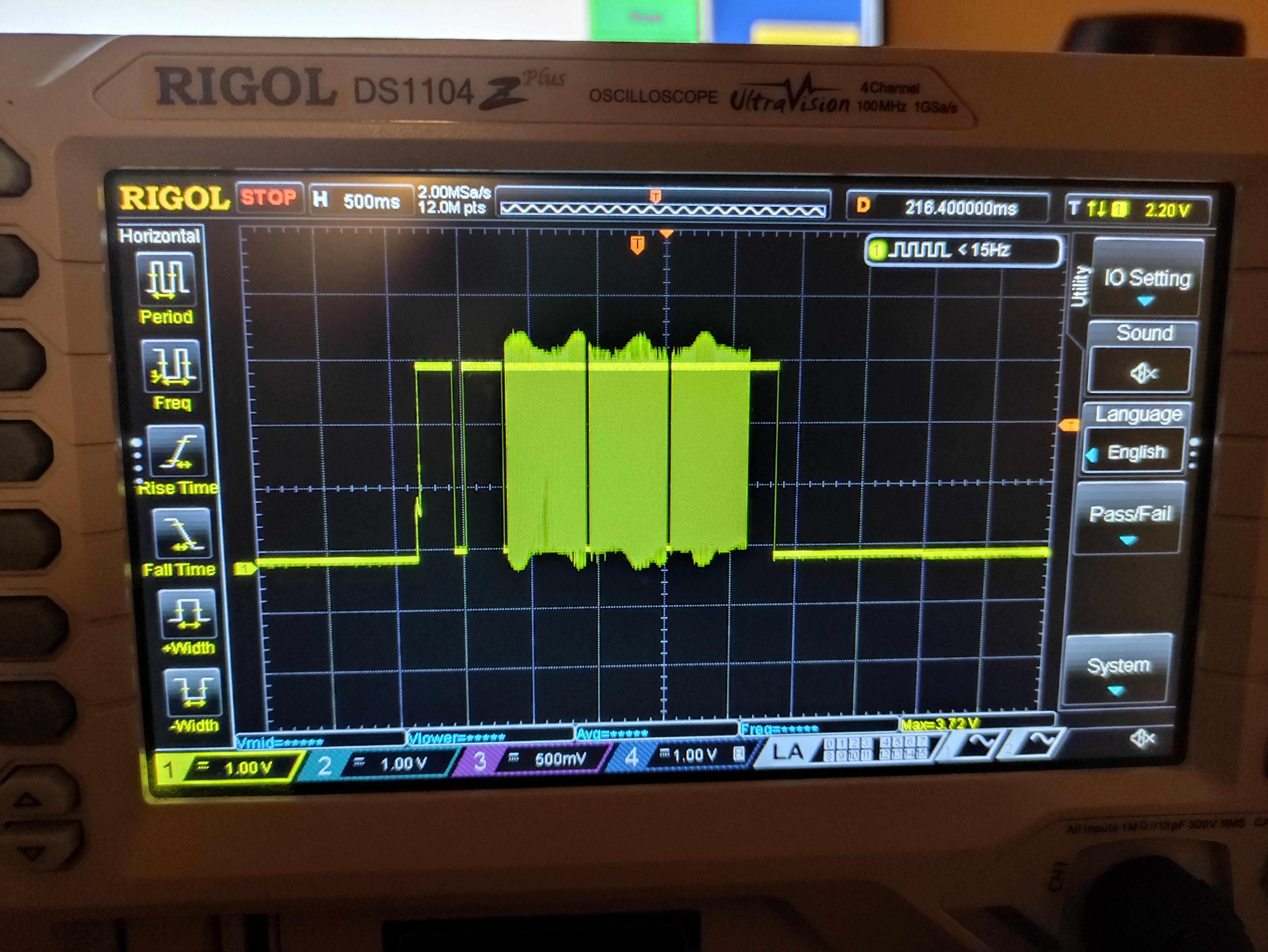

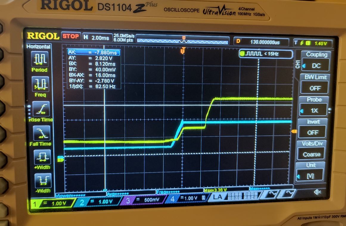

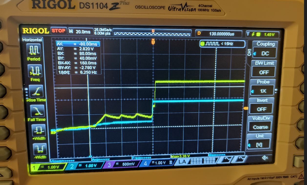

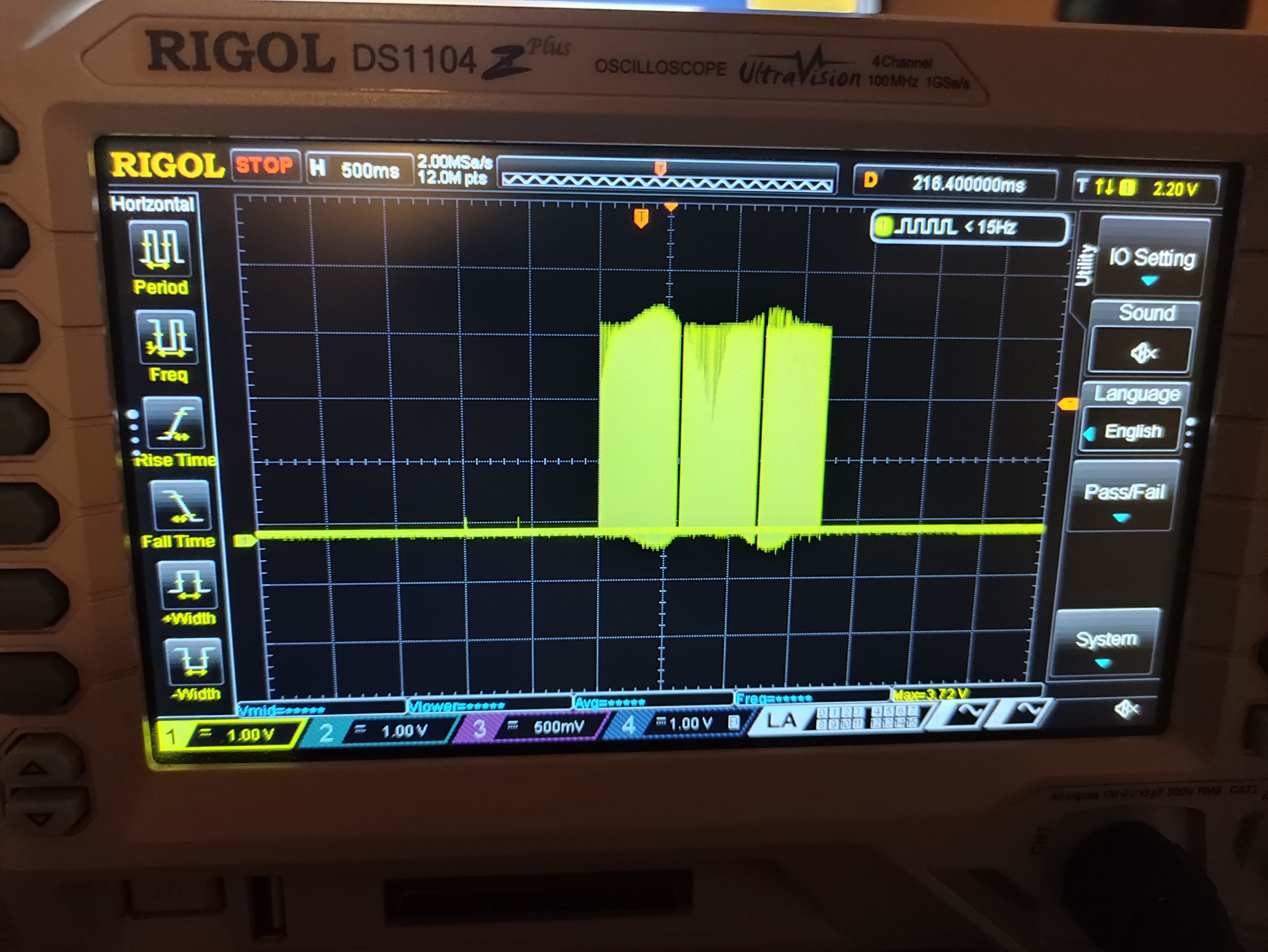

- Turning scanner on with host/USB cable connected: VBDET is maintained at 3V, and when scanner is turned on RPU_ENA goes high (3V), but only during ~3 seconds. Then, it stays 0V forever. During the ~3 seconds high, an interrupt is detected in the host (Windows device manager refresh), but then no USB device is showing up. The following figures show the D+ D- and RPU_ENA signals during scanner boot up (they are not synchronized because I have only an oscilloscope port to sample the signals):
- D+ line:
- D- line:
- RPU_ENA:
- D+ line:
- Plug out/in the USB cable with the scanner on: VBDET goes high (3V), but RPU_ENA is maintained always at 0V. No interrupt is detected in the host (so, no refresh is observed in the Windows device manager).
Can anyone expert in USB2.0 help me?
