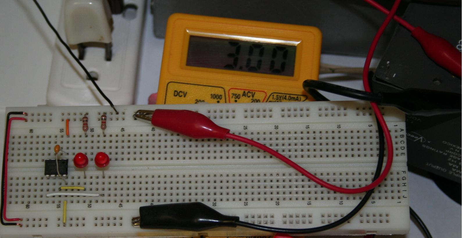

Looking at the input with a scope, none of the spikes are anywhere near 90ms wide, but they are rather large and very ugly. If the pic crashes, shouldn't it start over at the beginning of the program, which would immediately reset the outputs turning off the leds?
When it gets in this impossible condition, all I have to do is send a valid input and everything works properly, so it's not getting hung up anywhere, it just didn't reset the led. And of course, it shouldn't have set the led in the first place.
Is there some maximum rate at which you can check inputs? Much of the code I have seen checks an input, delays a bit, and checks again for debouncing. Is there some minimum delay after setting outputs before you can check inputs again?
The whole reason for going to a pic for a flipflop was to handle this noise problem, as normal IC's weren't able to, but the pic is showing the exact same problem. I was sure I could handle this in software.
I put the pic on a breadboard with nothing else on the board but two leds on the outputs and a 47k resistor from the input to ground. Powered it from a small lamda power supply set to 3 volts, the voltage of the target circuit. I connected the VSS to the AC neutral line also, since this will be it's normal environment, and is probably the source of the noise. I got the same glitch when creating the noise spikes. So this eliminates any problems with the qprox or any of the other circuitry.

Hi Jim,
You got a .1-ufd bypass capacitor across and located as close as possible to the VDD and VSS pins?
Mike
Yes, see attached picture of entire circuit. Notice that there is nothing attached to input gp2. This is because it is no longer an input. I started stripping down the program until I got to this:

so there is nothing left to the program. No inputs, the only write to output clears everything. I get the same action when I generate the noise by plugging and unplugging the transformer. The led's light up randomly. Obviously, the pic is not resetting to the beginning when there is a problem, but how do I stop this random behavior?

This might be a shot in the dark but you can try turning the Brownout detection ON to see if situation improves. This would stop the PIC running wild if there are voltage dips on the supply.
__config _BODEN_ON
I agree with the BrownOut Detect

Well, the brownout had no effect. I went back and tried more capacitors however. After 4 .1uf caps, it started to settle down. I think I'll just use 1uf for insurance. I guess the regulator I'm using isn't as good as the specs indicate. And I'm sure it will be less of a problem when soldered to a small circuit board rather than being plugged into a breadboard. Perhaps a transient voltage suppressor would help.

Ok, I finally found the problem. It was an intermittant connection in the breadboard I was using. Everything is solid now.
