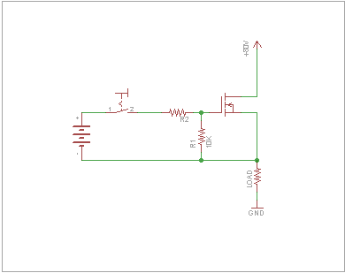

I don't see why a battery can't be used like this:
R1 is to turn off the mosfet. Since you probably will not be switching quickly and often, I would use a value that did not drain the battery too much. The larger the resistor, the slower the switch off will be. I suggest something between 1K and 10K. R2 is a gate resistor. Its purpose is to inhibit gate ringing. In this case, you can probably eliminate it. If you include it, use a low value, such as 10 to 100 Ω.
You may have a problem with switch bounce, which means each time you turn on or off the mosfet, it will actually be transitioned several times. That could cause unnecessary heating. I would try it without debouncing first. Then add a suitable RC debouncer, if needed.
As a safety note, remember the negative terminal of the battery will be at approximately 80V relative to ground when the mosfet is on.
John
Thanks John, this is exactly what I was thinking of, it seems very simple and inexpensive.

Both designs still have a mechanical switch, which is the most unreliable component.

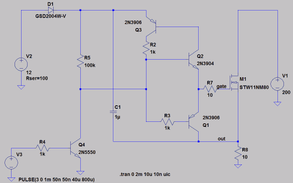

Here's a simple high-side driver using a bootstrap capacitor rather than a battery. The simulated turn on characteristics are a 300ns delay and 320ns rise time (to 200V - will be proportionally less for 80V). Turn off prop delay of 50ns and fall time of around 22ns.

It can be simplified, though at the moment it has pretty good performance and will take up much less space than your 9V battery and will be cheaper.
