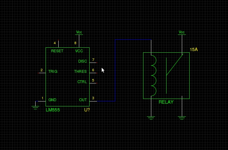

Can someone please tell me how I would go about replacing the Relay in the attached schematic w/ a FET?
-Chris P
Well, since when the relay closes, it shorts the 15V supply to ground, I wouldn't. :D

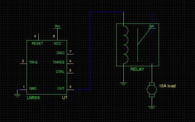

What is the load?
Its a Solenoid designed to run on 9V, but I am planning 7.4V. Resistance is 0.7ohms, so, I think w/ a fully charged battery it will pull over 11A. The 555 timer is there to precisely control the duration of power applied to the solenoid.
And just to upload a more accurate schematic with the load shown, here it is. The symbol is for a motor, but Im really driving a solenoid.
Do you know what a snubber is? Are you trying to run the 555 on the same power supply as runs the solenoid? What triggers the 555?
No.
Yes, although Im not entirely opposed to running separate supplies. Id prefer a single power supply though.
Just a regular switch. The 555 is in monostable mode so that no matter how long the switch is pressed, power is only applied for a predetermined duration.
Ok. Folks have tried to use the 555 (and ucontrollers) to pulse highly inductive loads (with an intervening NPN or NFET transistor), and have complained that the inductive spike generated as the 555 turns off causes the 555 to retrigger (or reset the uController). If you are willing to give it a go with a common power supply, then it is essential that there be 10uF and 100nF bypass capacitors (in parallel) on the Vdd to Vss pins of the 555 (with almost zero lead length), and a 100nF on the unused VCO input to Vss. There also must be a diode snubber (or at least an R-C snubber) across the solenoid coil. There was a long-running "Snubber" thread on this web site a few months ago.
Basically, you will need a T0-220 style NFET mounted on a heatsink, with a gate threshold of <4V, an max Id of ~25A, Vds of > 50V, Ron of <0.1Ω. You will ground the source (battery negative). The drain goes to the solenoid/anode of the snubber. The other end of the solenoid/cathode of the snubber goes to the battery positive. Place a 10Ω, non-inductive resistor between pin 3 of the 555 and the NFET gate.
If you experience retriggering after bypassing and adding the snubber, then the next suggestion is to use a separate battery for the 555, and use an opto-isolator to keep the 555 battery totally isolated from the solenoid battery. (No common ground between the two).
