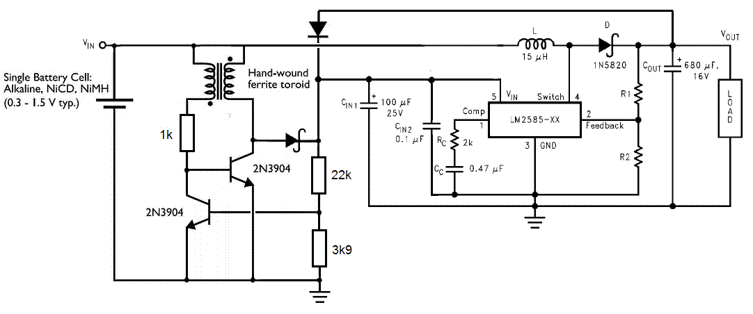

Just an idea but you could use a Joule Thief as a bootstap to allow an ordinary boost SMPS IC to work from a single AA cell draining it until it's dead.
This idea only uses the Joule Thief to get it going, once the output voltage is up to 5V the Joule Thief is shut down and the controller IC uses the output as a power supply.

Depends on the voltage the SMPS requires to start up and what it will actually run down to once it's started. Not sure if it'd be worth it. Sounds like an expensive tack on to get a marginally more amount of power out of a single AA. That's what Joule thiefs are after all, use 2 AA's and almost all your problems go away.
The LM2585 here works down to 4V.
Yes you can buy some ICs that work down to much lower voltage and yes adding an extra AA solves the problem.
Expensive? I think you'll find an extra AA is more expensive than adding this circuit.
With an SMPS an extra battery is a win win. Generally batteries are the problem of the consumer. As long as the efficiency is high you're adding free up time to the device, unless space is at a premium in which case you wouldn't be using AA's anyways you'd be using lithium cells which again solves the problem. Considering how much current is available once a battery gets that low too though I'm not sure how practical it would be. You'd need a micro power SMPS and effciency would be really low. I'm not sure what the internal resistnace of a AA is when it's nearly dead but given the voltages almost any resistance will really kill your ability to draw any useable current out of it. Joule thiefs are nice but once they battery gets that low you're not gonna get much out of it.

TPS61220 works down to 0.7 volts. There are many parts that work to 0.9 volts. Below 0.9 volts there is not much energy left in a battery.
I get pushed to make my products work below 0.7 volts but there is so little energy left that it only adds minutes to the battery life.
