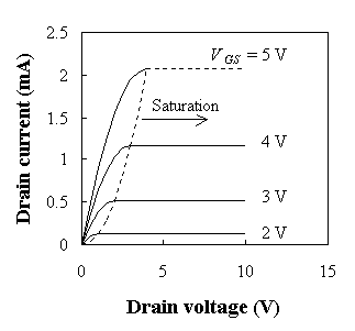

Nitpick
This is a little bit of information which may just serve to confuse people, but I think proper terminology is important.
I'm offering this because Oznog (nice name, Gonzo) and others refer to the saturation region of a MOSFET erroneously. It is just the opposite of a bipolar transistor. See **broken link removed**, and the graph below. The region to the left of the dotted line is called the linear region.
I've been designing DRAM chips for 7 years, and, because of my long previous experience with bipolars, I still have to think twice about it.
