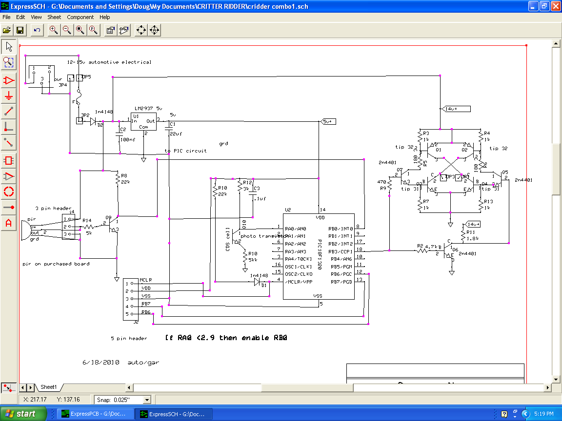

Presently I have a 2n2222 controlled by a PIR that takes an input LOW thus triggering the program.
Wondering If I could just use the ADC input with the Cds or photortransistor in series with a couple of resistor for a voltage divider. When light hits the sensor it shuts off the PIR input.
If I can get PAINT to be able to save a png file then I would post a schematic.
Will post an old schematic
here Q9 takes RB0 LOW but thinking of configuring a way to use similar to Q10 bt add another resistor to ground in series w/ photo sensor.
Then using ADC
WHILE TRUE portx <3 then port Y is enabled?
something along those lines. Just thinking out loud while tryiong to learn EAGLE pcb using the tutorial from sparkfun. Where is 1xFRAME-LETTER??

Got PAINT.NET working now to configure ADC to control port RB0 so in daylight the PIR is disabled. By adjusting R10 (need a pot instead) then adjust to daylight.
proposed code using swordfish but need to see if Swordfish has enable?
open for suggestions

MrDEB I can't open the attachment
I'm not a pro @ this stuff . But I have done what your asking. Not with swordfish but Pic basic Pro and assembly I just hook up the photocell as a voltage divider (I add a pot) for my use I leave the PIR active and depending on dip switch settings and the adc conversion it either does something (turn on camera, turn on light,etc) or jumps to delay. Because my stuff runs off batteries I use a output pin to power the photocell/voltage divider and turn the output off and on as needed.
maybe this will help not hurt you OR maybe some of the pro's will chime in
chow
LDR=1 'POWER UP LIGHT SENSOR
Pause 20
ADCIN 0,NIGHT 'READ AN1 & STORE IN NIGHT VAR
PAUSE 250
IF NIGHT=<550 Then GOTO DELAY ' IT'S DAY in night only mode
Pause 25
LDR=0 'power down light sensor
goto somewere or do what ever
