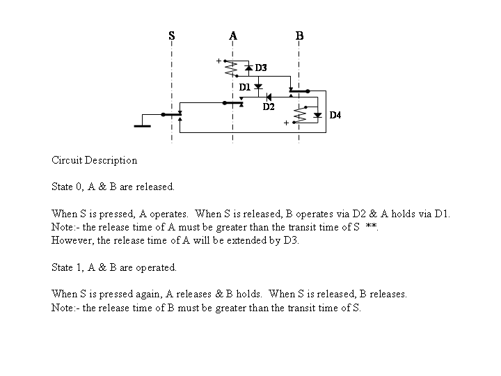

i have a motor and a spring operated leaf switch,and what i want to do is when i tap down the switch i want the motor to go in the other direction, and when i tap it again i want it to go back the other way,does anyone know what type of ic i might need to do this.
You don't necessarily have to use an IC. here is a relay version.

shaneshane1 said:
its a mini servo 4.8V-6V,i cut a peace of plastic out so it can keep rotating.
Do you mean a modifed servo motor like this?
If so then you DON'T reverse it by reversing the power connectors; that will damage the servo. You have to vary the pulse width on a continuous rotation servo to forward / stop / reverse it.
seem way to complicated just to get a motor to move,how would i go about getting that switch to work on a normal dc motor???
its a momentary switch with a metal stick on the end of it ,when you hold it down it makes contact and when you let it go. it doesnt make contact,so does anyone know a easy way to set it up so that when it is taped down the motor goes in the oposite direction.its like a bumper switch on the rover robot.
