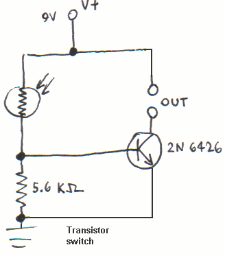

I'm trying to have a circuit, which is a simply LED flasher, to be either turned on or off depending on how bright it is. I'm using a photoresistor and a transistor to get this to work.
Here's what I have so far:
I unfortunately lost the specs sheet for the photoresistor, and I have little indication now of its resistance value. I have a multimeter, but it's analog and it's highly inaccurate. For example, it reports my 9V battery to be 13V. It's even more inaccurate for measuring resistance. But it looks like the resistance of the photoresistor ranges from 1K ohm in full light to about 40K ohm when I put my finger over it.
Regarding the 5.6K ohm resistor: I picked its value in order to drop the voltage down to about the required voltage to turn the transistor on.
The problem is that my transistor is currently operating as an amplifier. If there's a lot of light, my output has a lot of current; if there's relatively little light, my output has relatively little current. I want it to operate more like an on/off switch. What can I change to do this?
You've built yourself an emitter follower- the emitter of the transistor is going to look like the voltage at the base, minus an offset (Vbe, somewhere around .7V), unity voltage gain, large current gain.
What you need is a transistor amplifier with some gain - look in your text books/online for a "common emitter" amplifier. With enough voltage gain, and some nonlinearity (i.e. transistor won't turn on until vin >= .7V), you'll have something that looks like a switch.
The emitter of a transistor doesn't have any voltage gain. The emitter's voltage follows the base voltage.
The collector of a transistor has plenty of voltage gain when the emitter is grounded.
Wire it like this and adjust the value of the 5.6k resistor to change its sensitivity to light.

Thanks for the help, I have a working switch now. There's still a "gray area" where the circuit is half-powered, but it's significantly smaller now.

Increase the gain by using a pair of transistors in a darlington configuration.

svk said:
The voltage that comes out of the emitter is actually independent of what goes into the collector?
The collector is not an input.
Instead, it's dependent on the voltage at the base?
Correct. The voltage gain of an emitter-follower is 1.
The current that comes out of the emitter is the current that goes into the base multiplied by the HFE value, correct?
Yes. The current that comes out of the collector is also the current that goes into the base multiplied by the HFE value, and with a collector load resistor there is a voltage gain.
