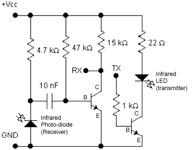

hi, my parents wont allow e-marketing and the local dealers here dont have any photodiode. so, i bought an ir receiver, as the photo diode in the specification was supposed to act like an IR receiver only. The model i bought is HS0038(visay).
the circuit im talking about is attached to this post.
more details about that circuit here **broken link removed**
now, how do i connect that receiver in place of the IR photodiode?

There are a few sites that have datasheets. I looked at the datasheet for the HS0038A and HS0038B from Datasheet Archive - Free Datasheet Search Engine :: PDF Datasheets :: Data Sheet :: Datasheet :: Application Note : çš„å￾‚æ•° : 规格书 : 技术资料 : ë￾°ì￾´í„°ì‹œíŠ¸ : データ・シート : Fiche technique : Datenblatt : опиÑ￾ание . I did not compare them. They look the same.
The datasheet shows that it needs a regulated 5V supply with a 100 ohm resistor and a 4.7uF capacitor for power. Its max allowed output current is only 5mA. It is tuned to 38kHz. It has automatic-gain-control which reduces its gain if the 38kHz IR signal is continuous because it expects data in bursts.
It might replace the photo-diode and transistor parts in your Rx circuit.
If you know all this forgive me. It is often difficult to tell.
The photo dioed will respond to any IR light and pass on the 38 kHz signal. The receiver will go high when 38 kHz IR light is present. This makes a difference in the receiver software. But it is a good difference in that it is simpler.
You can build just the transmitter from your schematic using the transistor the IR LED, 1K ohm resistor, and the 22 ohm resistor. You should find a circuit for the receiver in the data sheet. They are quite simple.

The photo diode will respond to any IR light and pass on the 38 kHz signal. The receiver will go high when 38 kHz IR light is present.
The output of the IR receiver IC does the opposite. Its output goes low when it receives IR radiation.
Yup you got me. Active low. :)

A photo-diode needs to have a high gain amplifier to work properly. The Vishay IR receiver IC has the photo-diode, the amplifier and a lot of other important things.
The Vishay IR receiver IC must have the power supply that is shown in its datasheet.
