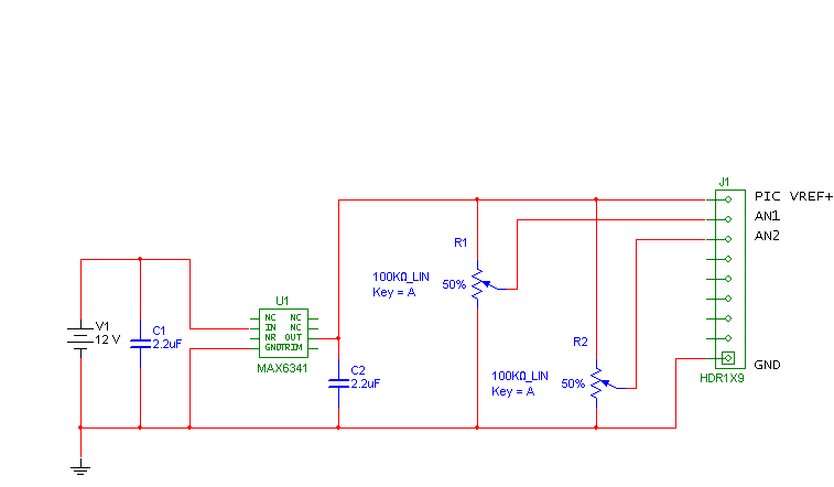

so would this be a valid circuit - does it need anything else.
does it matter what pots i use (values)
eg. will it make a difference between a 1k or a 500k, i know voltage wise it will probably be fine but what about current?

The datasheet for the PIC's adc input states that the input resistance/impedance must be =< 10K for specified accuracy.
10K pots are the max value for adc inputs, no series input resistor is required.
The PIC expects the +Vref to be => 2.5V or =< Vs

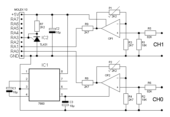

Could i use 13 channels just by adding more of the input modules from your tutorial (attached) or would i need to add additional parts?
Hi Nigel, I will wait a few days before building the circuit so that i can collect all the bits to build it as in your tutorial.

Whats the circuit diagram you posted supposed to represent.?:)
Its possible to add more analog source inputs by using analog selector ic's.
Some PIC's have 14 analogue inputs anyway (just happened to notice while looking at 18F series chips), so 14 buffer amplifiers could be connected to one PIC - or, as you say, switch them to a smaller number of inputs.
BTW: conventionally circuits are drawn the other around, input on the leftside.
My fault - but it's not like it's a conventional circuit with an in and out, it's was added on to a previous tutorial board, which is why it's that way.

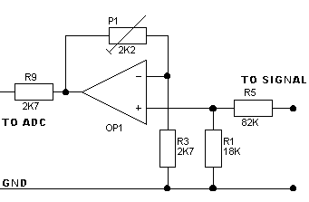

Hi, sory for the confusion.
The circuit i posted was part of nigels 0-10.23v analogue board, which i have attached so it makes more sense.
I was just wondering if i could use more of the input stages to feed more analogue inputs.
LIke I said, yes you can.
