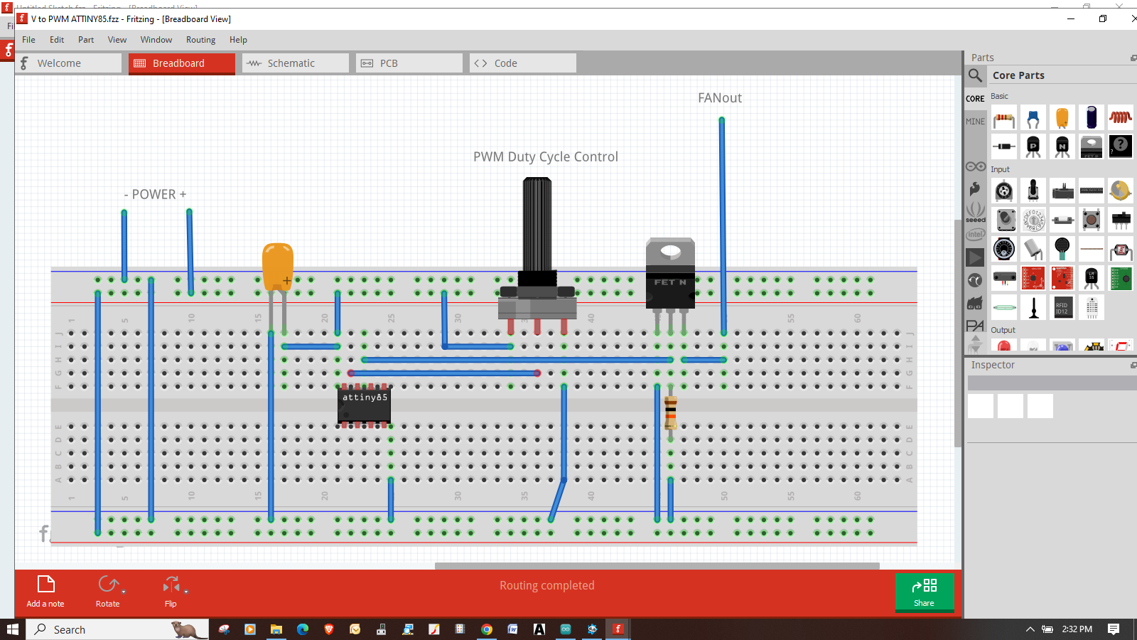

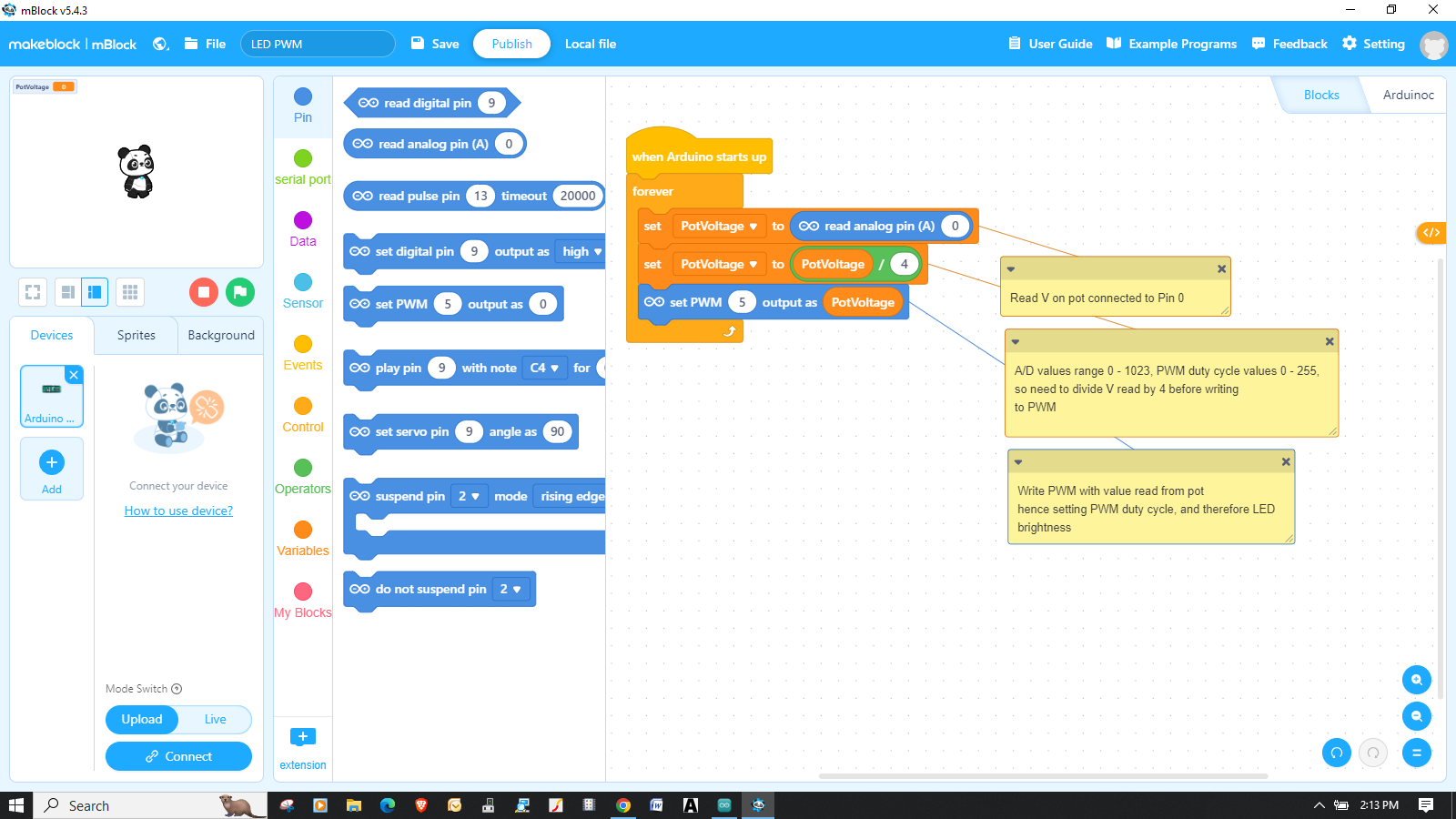

Simple V (pot or voltage) control to vary duty cycle w/o affecting frequency :
Top screenshots is mBlock tool to program the Attiny85. Uses internal A/D to read a pins
V and use that value for the PWM duty cycle value.
A much more sophisticated approach :
Regards, Dana.
Regards, Dana.
Hi, Thanks for the reply. And your solutions will work perfectly. But I was hoping to go with a simple solution using a 555 timer, rather than using an MCU.
