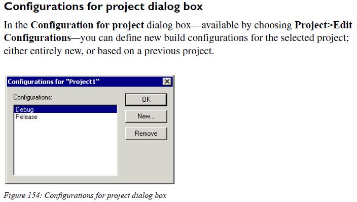

Hello, I work with IAR, and would like to ask you something about it.
There is an option there to create my own configuration.
Its just that I dont understand what is the duty of a configuration?
What parameters do you set in this configuration?
Here is a picture that illustrates the configuration i'm talking about.
relay-jpg.25991
Thank you very much!

It allows you to develop multiple software products on the the same hardware and firmware base. In the firmware there may be conditional compilation statements of the form
#if defined(__PRODUCT_1__)
#define product 1 options
#elif defined(__PRODUCT_2__)
#define product 2 options
#else
#error No product options selected
#endif
Now in each of the configurations there is a box where you can define various symbols that are appropriate to the configuration such as:
__PRODUCT_1__ or __PRODUCT_2__
Right clik on the project name, select options, select the compiler (ICC8051), select the #define tab to enter the #define symbols for that project.
Additional projects allow you to compile a different set of source files which are nonetheless part of a common code base for a hardware platform. For example some products use the serial port and some do not.
Get it?
