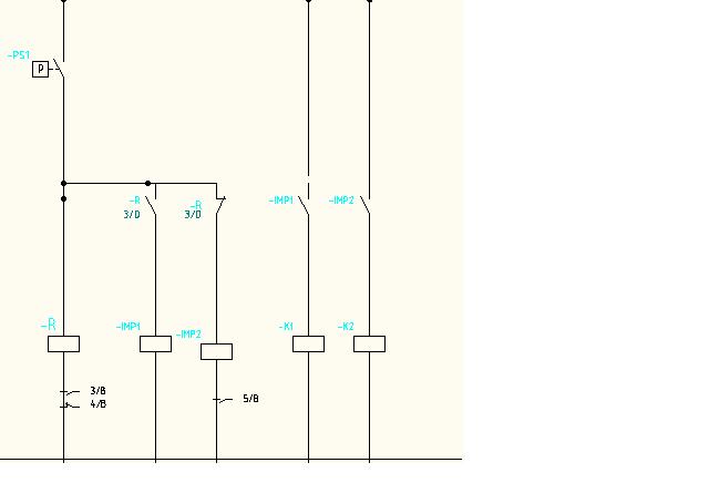

Now please find attached diagram for how i thought it maybe. I used two impulse relays but i am not sure i am right because of two reasons:
1- if PS1 was closed, R will be energized, so first NO contact will close and energize IMP1 to operate Pump1 , same time, NC contact of R will open, so will it energize IMP2 or not?? (AS i know impusle relay is energized due to transition not due to maintained power).
2- Probably i am required to do the circuit with only one impulse relay.

My modified Circuit
Hello Sir;
I modified my circuit and attached it again, please check.
My question is : Will IMP2 be energized or de energized when PS1 closes????
I need it to be off & IMP1 to be on, this satisfies wht i want.
I hope it openes with u, if it did not, please try opening it from Paint program.
Both will be off same time when the whole booster is switched off or when the pressure switch does not send a signal.
First, in your original post you said there are two pressure switches. ???
In the first circuit either K1 or K2 will be on, they never both be off as long as there in power to the ladder rails. "or when the pressure switch does not send a signal"? Is there a second pressure switch that supplies power to the rails?
In the second circuit K1 will be turned on whenever the P-switches closes, but K2 will never be activated. With P-switch open there is no power to R, INP1 or INP2. With P-switch closed, R is powered opening the contact to INP2 and closing the contact to INP1 > K1.

I can understand "when the whole booster is switched off" how both pumps would be off, but not "when the pressure switch does not send a signal". I thought that the pressure switch's on/off was what was to cause the circuit to switch from one pump to the other. ???
Maybe you can explain in detail what you are trying to do, what the total system involves. Then, we can help solve the problem, as opposed to trying to solve the solution. ;)

What's the "booster" for?
The booster is required to increase water pressure (by pumping it) when pressure switch detects drop in the system pressure.
This means, pumps are off as long as the pressure switch is opened (no pressure drop).
When drop occurs, pressure switch closes (goes from open to close),so only one pump P1 is required to operate.
If presure compensate, pressure switch opens (goes from close to open) and P1 must shut down.
When preure switch cloes again (goes from open to close), P2 must run, then whenpressure switch opens( goes from close to open) P2 must shut down, and so on.
So, the sequence required in the circuit is :
PS Normally Opened ---> P1&P2 OFF
PS closed ------------> P1 ON & (P2 OFF)
PS Opened ------------> P1 OFF & (P2 OFF)
PS closed -------------> P2 ON (P1 OFF)
PS Opened-------------> P2 OFF (P1 OFF)
. so on, it's a "toggling mechanism"
