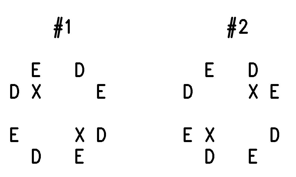

The biggest problem you're going to have, and I don't know how they get away from this in their laser pad unless they multiplex power to the emitters one at a time and now that I think about it that won't work either... anyway, the problem you're going to have is with multiple break points. If you put both feet down, you won't be able to tell which X break goes with which Y break... ex:
Let's say you set up your infrared like the BELOW. ok, one foot goes down, no problem, one broken x and one broken y.... but with two feet placed, you'll have two broken x's and 2 broken y's, and won't know which x goes with which y.... #1 gives the same output as #2

I see how the breaking multiple beams can be an issue, but I'm not too worried since Dance Dance Revolution uses the up, down, left, and right positions and not the diagonals, so at those positions only one beam should get broken.
