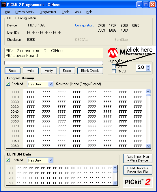

MrDeb Are you wanting to power target so you don't have to unhook it and power up
to run your code. The easy way is to open the pickit2 build and load in swordfish and click the vdd like in the pic. Just make sure you turn the power back off when you load a new code or it will not let you program the chip with swordfish.

will try as per be80be
I am using junebug to program but will try the Vdd box in pickit2
just need to compile then save the hex file for use in the pickit2 program.
NO NO NO NO You just use it to turn on the power that's it use swordfish to load your hex and the pickit software to turn on the power it's smiple

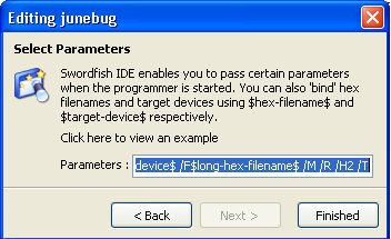

I hate to say it but that don't work to power target. What bill posted is the same command I have been using when I started using swordfish. It will not power up the target. It may work if you have power on the target I always use the usb for power it there LOL
this is what you would want to use
/PPIC$target-device$ /F$long-hex-filename$ /M /R /H2 /T

4) MCU needs to be powered from PICkit 2, MCLR configured as MCLR. Switches needed to run after programming: -R -T
It looks like the R and T switches need to be used with a 2nd run of pk2cmd.exe. Maybe someone can give it a try.
I am not sure if you can ask swordfish to run 2 commands. Maybe call a script/batch file to do it.
/PPIC$target-device$ This switch sets target
/F$long-hex-filename$ This switch sets file
/M This switch programs the pic
/R This switch Release /MCLR
/H2 This switch delays 2 sec
/T This switch powers target
This is what you want swordfish to run for the command of the pickit2 or junebug or any clone like the pickit2
You put that command right here and then you can hit f11 to compile and program and then it will power up the target
