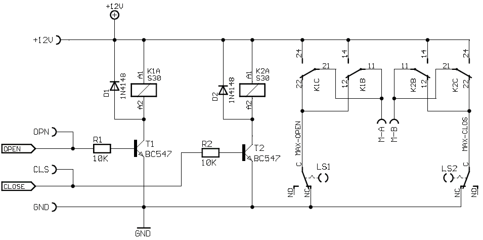

What you need, I believe, is a limit switch. It senses mechanically th closed or open position ofyour vanes. E
Hi cimbri,
your circuit should be similar to the one attached. Limit switches interrupt motor ground connection if the max position in either direction has been reached.
Boncuk

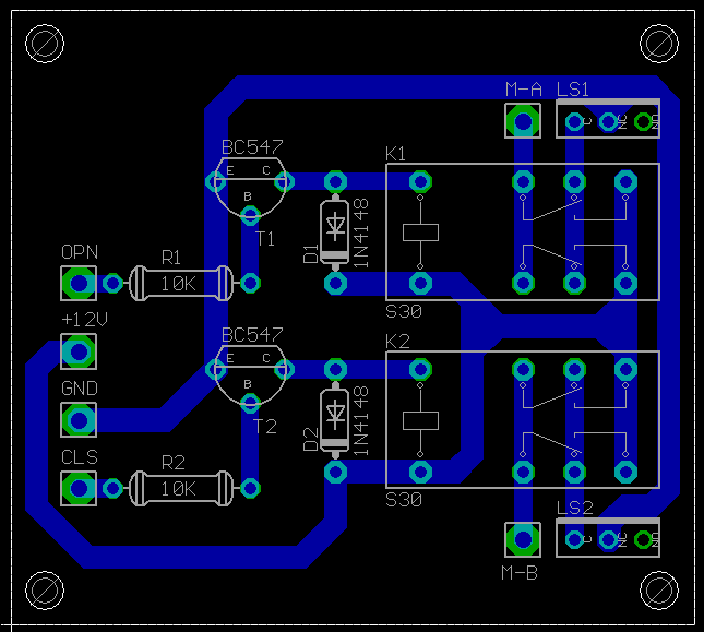

Here ya go -
open-close-gif.57284
open-close-brd-gif.57285

Sorry, I mixed the signal nets for the limit switches. The L/H switch is max closed and the R/H limit switch is for max open.
So the switches must close diagonally for operation.
