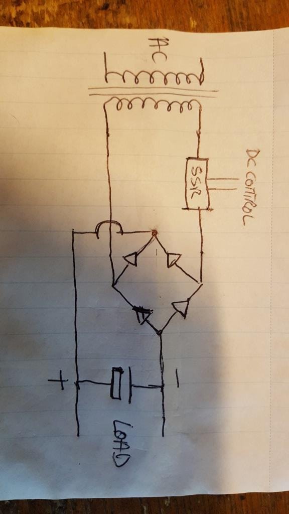

As this room is discussing a similar topic, perhaps someone can assist me with my own problem. I have a large 2Kva 100v ac Transformer which is feeding into a Bridge Rectifier the input to the Bridge Rectifier is being pulse switched with a 100A SSR. I have put an assortment of CR snubber circuits and MOV's across both the AC lines into the rectifier and the DC lines out of it. I have also put an MOV across the AC contacts of the SSR.
Despite all of this now and again the Rectifier goes short circuit and has to be replaced. Sometimes the SSR also goes short circuit and needs replacing, but less often. Both devices are rated for 1600v operation. which is well in excess of the operating voltage of my circuit. I have concluded that my MOV and filter circuitry is not helping as anticipated. I believe the failures are caused by back emf spikes from the transformer, produced when the SSR disconnects. I would like to know if perhaps I am connecting my MOV's wrong ?
It had occurred to me that if my MOV is directly across the transformer output as it presently is, when it clamps it may aggravate the problem by creating a closed loop instead of diverting the excess energy out of the circuit. So what I would like to know is this.... Should I be connecting an MOV from each side of the transformer AC output to my Earth grounding point instead ?. Also if I do so, how would I do it without creating a a further closed loop as both MOV's would be joined together at the grounding point ?.
Would greatly appreciate some help on this issue asap !.
Rob
Can you post a schematic of your circuit as you do not say if the SSR is between the transformer and the bridge or between the bridge and the load. Can you also geve details of the nature of the load. An SSR sould not have the same problems as a normal relay as it does not cut the power to the load as soon as the drive signal is removed. It remains conducting until the next zero crossing of the current waveform.

Sorry, no Schematic im afraid, as the whole thing came from my own head and has been designed as an ongoing project for the past two years. If I was asked to rebuild it without the original to copy, I couldn't.
The SSR is between the Transformer and the Bridge. The surge current figures can be pretty high and DC-DC SSR's in the 100A range can be very expensive. However DC-AC 100A SSR's are pretty cheap and easily obtainable, which is why I went that route.
The High current pulsed supply produced from the output of the Bridge feeds into a "very" large capacitor. This then feeds another device, which is is a not an easy one to explain as the nature of the load can change. It is an intelligent device which adapts itself to the supply, in order to get the maximum power. It works in a similar way to a Solar Inverter.

I am also 99% certain the cause of the spikes are when the SSR disconects between pulses.

The SSR is a Zero Point crossover type and the control circuit already does this. However there are still spikes getting through !. The Inductor is not being suddenly disconnected from its source. The voltage into the inductor primary coil remains constant. However it is the load which is being disconnected suddenly and thus the spikes are being generated within the secondary coil.
I really did not want to get into an in depth conversation about the circuit design. And I don't want anyone to try and figure out ways to stop the spikes in the first place. I simply wished to know if I am using the MOV correctly by placing it across the output of the secondary coil. Or should I be using two MOV's linked together at an Earthing point ?.

I also have a CR Snubber circuit across the secondary side and have seen with my scope that it does help with the smaller spikes. However the larger spikes which are causing the problem are rare and may occur a couple of times a day. Unfortunately I am not going to sit an stare at a scope screen all day to catch it.
