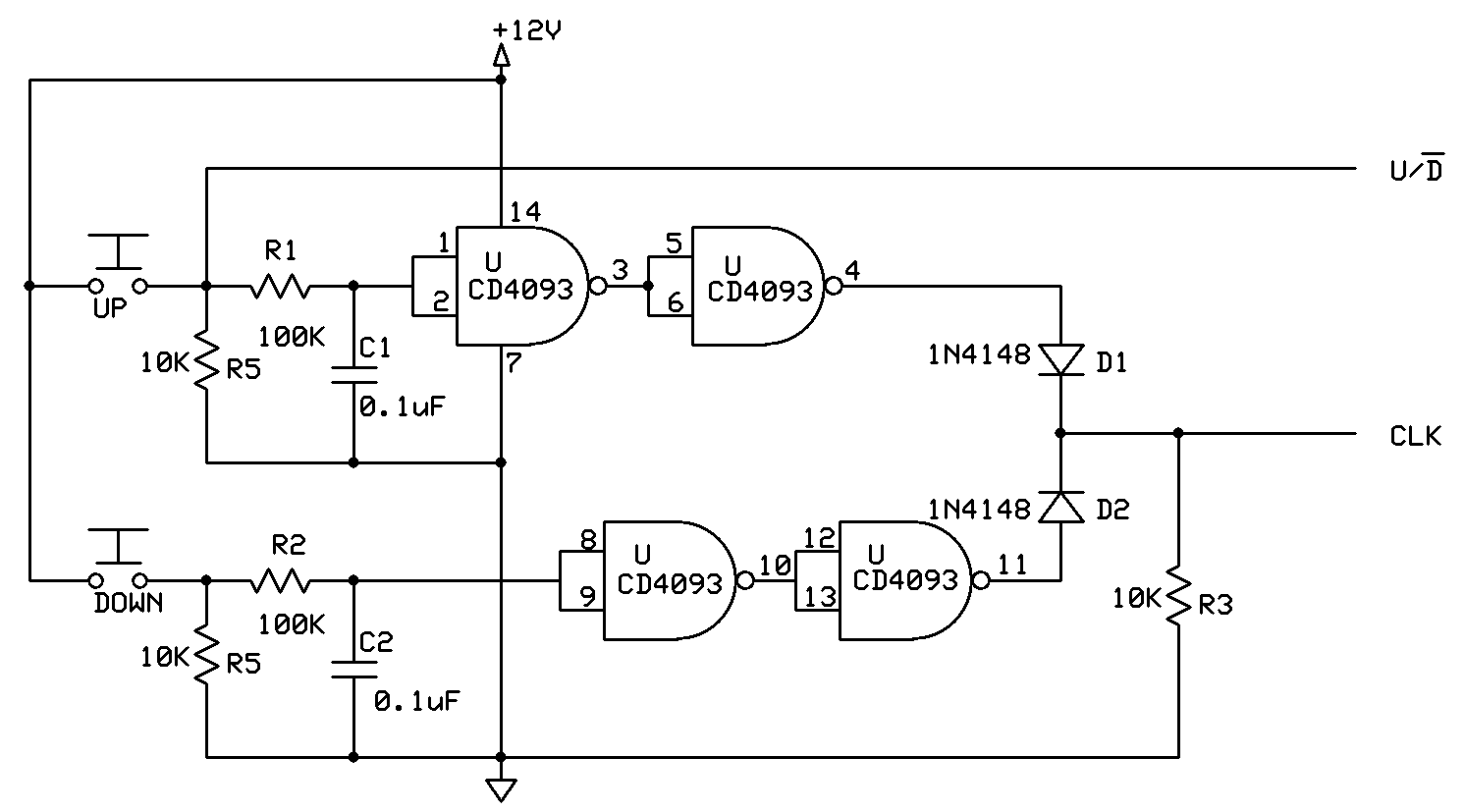

Another option. The input RC networks provide switch debounce. Since pin-10 on the 4510 needs to be high before the clock for an UP count, the upper RC network and the Schmitt NANDs provide a slight delay on the rising clock edge. Pin-10 is high when the clock arrives. On the down count, Pin-10 is already low. The lower NANDs provide a fast rising edge to the clock pin. The diodes make an OR gate to steer the UP and Down clock pulses. I have not built this, so any comments on glaring flaws are welcome. ;)
Ken

Right, just tried it out and it works, but there is a niggling problem. Countdown works perfectly, (that i'm aware of.) But sometimes countup doesn't register a button press, (not sure if it's my wiring or not.)
Actually, it seems to be working 100% now, (my tactiles don't fit onto the breadboard too good, so that could've been it.)
Thanks again bud, you've been a great help :D

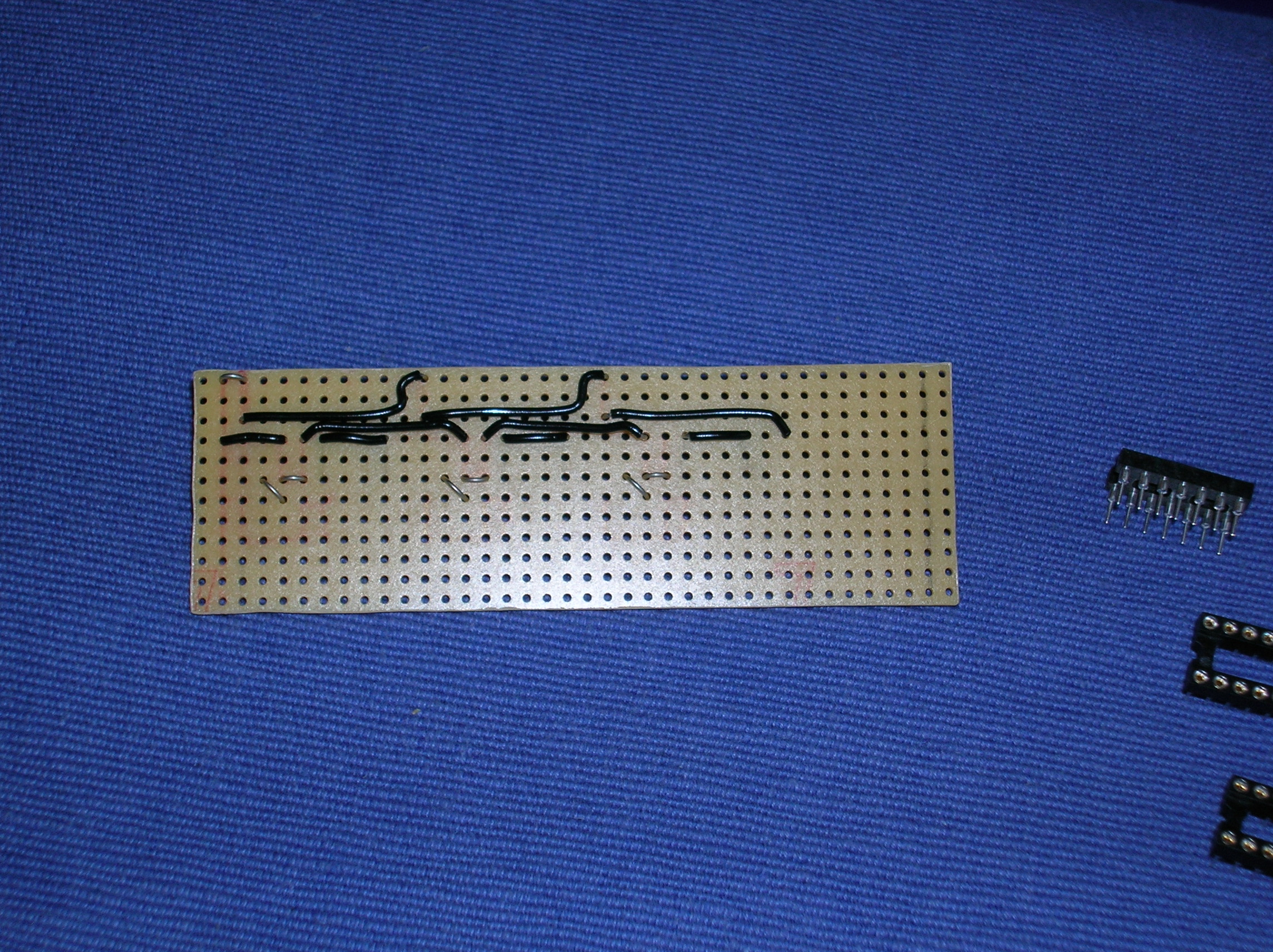

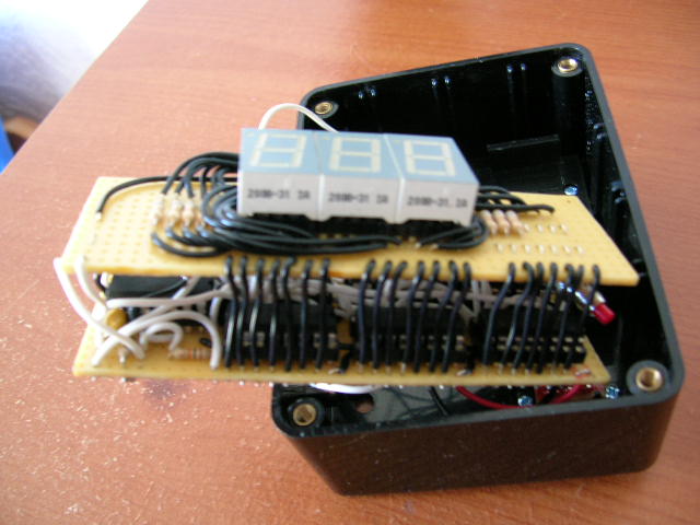

Ooops, meant to have got back sooner. My counter has been completed and put into a nice case. It can count up to 999 as i didn't have the space to put anymore components in. Iirc the 2 veroboards are 12x36 holes, one contains the display and resistors and the other contains the 7 ic's. There was one problem though, after i'd roughly put it together it wouldn't count properly, but considering i'd been on it for hours that day i wasn't going to let it get to me, so i left it for the night. After a brainwave the next morning, i thought i'd check all the power rails. I found the problem, the 0v pin on the nand chip wasn't connected, oops. would explain why it was going mental!! That fault was from when i was drawing up how the connections were going to be made, i'd actually missed the connection at that point. Apart from that 1 connection the circuit worked perfectly! So, many thanks to everyone that helped and i'll get picks posted soon. :D

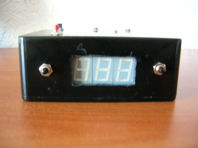

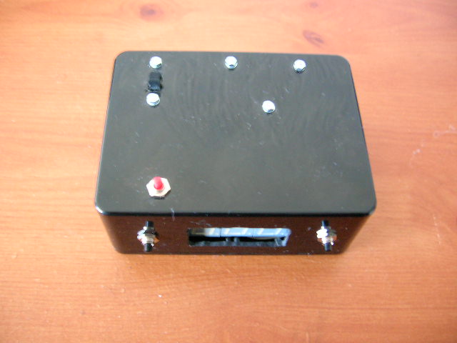

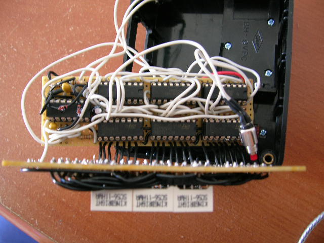

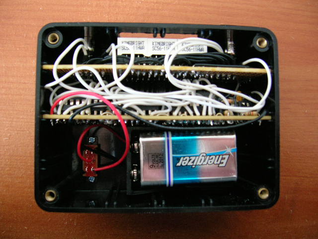

As you can see, space was very limited on this project!! The main rails were run underneath the dil sockets. ;)
Most of the resistors for the display are under the display itself. I was gonna take a pic of the soldering, but I have to admit, it's a bloody mess! :p
I was using veroboards that have track breaks every 3 holes, (It was very convenient for my project, dunno if it's classified as cheating or not.) ;)

It was just a little project to do, just to make sure I know what i'm doing. I was going to use it as a counter to count the winds on a machine that winds coils, but i'm not following that route anymore. I need some electronic skills for a major project I have yet to start. The good thing about the counter is that I can make external connections to operate the counter. Makes life a whole lot easier. :D
