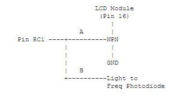

Urahara Member Mar 26, 2010 #1 Hi This thread came from another one asking some questions about changing the CCP2 pin of a 18F4620. I am thinking of using the same RC1 pin for the following : 1) Backlight brightness control of LCD module using PWM (Default behaviour) 2) Capturing of pulses generated by a light to freq photodiode, TSL230R (When required) See Diagram My questions are : 1) When RC1 is generating PWM to drive the LCD module, will it damage or cause problem to the photo-diode? 2) When RC1 is capturing the pulses generated by the photo-diode, will it damage or cause problem to the LCD module? Your comments much appreciated. Thks!

Urahara Member Mar 26, 2010 #2 Of course, I am not expecting both to be operating at the same time. But if one is doing so, will it cause problem to the other. Last edited: Mar 26, 2010
