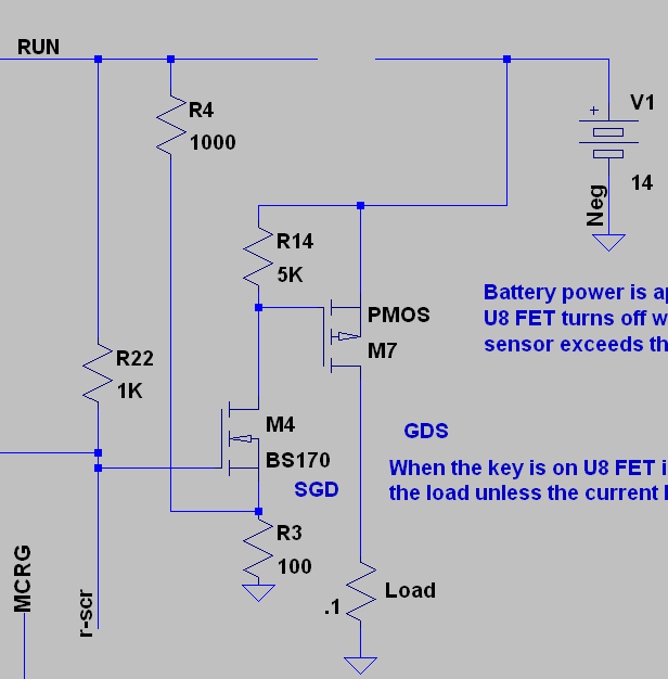

I've been trying to use and SCR to hold a circuit off after the current has reached a set level and cause a comparator to trip and fire the SCR, which should stay tripped, until turned off by another set of conditions. The problem I'm running into is that even when turned on, the SCR still has the customary .7 volt drop, which is enough other components in the circuit to turn on or not turn on as desired. Please look at the simplified circuit, is there another scheme for the use of SCRs? If I add voltage between the SCR and ground in the form of a diode, zener or LED to make the trigger voltage be higher, it also makes it easier for the input to turn it off , my best luck has been to put a LED in the gate lead to force the triggering voltage to above the off plus noise level of the triggering device which also has the .7 volt or more minimum.
It SIMs good, but so far I've had to rebuild the circuit several times and replace the U8 Power PFET a few times, even though the power supply is limited to about 7 amps.
The SCR is supposed to trip when the current from the motor reaches the end of travel and stalls causing the current to rise and stay tripped until the call for the steering motor is removed, causing the and gate to activate.
The above file is 000 Practice 16-12-02.asc, The entire schematic is 000 STEERING-RELAY 16-12-07 CORE + EOT.asc, but you probably won't be able to run the simulation due to components you won't have.
I will appreciate any suggestions or advice you may have, the SCR problem seems to be the last stumbling block, the rest seems to be working great.

M4 turns off at a very low voltage. The SCR +M2 can not pull that low.
Here, with a resistor divider, I moved the bottom end of M4 up a little. (R3, R4)
R3 could be a diode so you have 0.7V.
M7 will have a slightly smaller turn on voltage but I think that is OK.

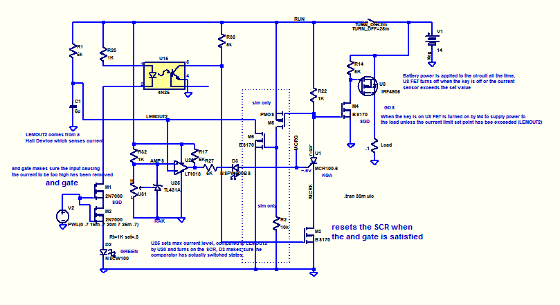

This is the end of travel detector for a H Bridge driven steering motor, it consists of wheat stone type input and an oscillator input fed to a LM339 quad comparator, (two of the outputs are fed to the and gate), that outputs are fed to 2 lm556 timers used a FET drivers, (this Part Works quite nicely) the current is monitored by the modified LEM HX 50-P/SP2 which is compared to a set voltage and trips the(this Is where I'm having trouble) SCR to turn off the P FET and stop all current to the motor and is reset by the and gate & opticoupler and every thing is back work. The P FET is also turned off when the key is off, power is always applied to the P FET, not my design.
I'm not intimately familiar with the S-R latch, does it come in DIP8, space problems. the opticouple was a handy way to use the output of the and gate and may be rethought, the Lem is HX 50-P/SP2, but I took it apart and made 4 loops around the Hall device, effectively making it a "HX 12.5-P/SP2 which has a 50mv /amp output from a 2.500 reference.
With a 100Ω below M4, it worsens my problem by raising Vd of M4 when turned on when it's purpose is to lower Vg of M7 turning it on harder, that may have been part of my problem because I was getting about 3 volts on the drain when I wanted 0, I'll have to look into that today, that could be what killed my FETS. I'll check back tonight

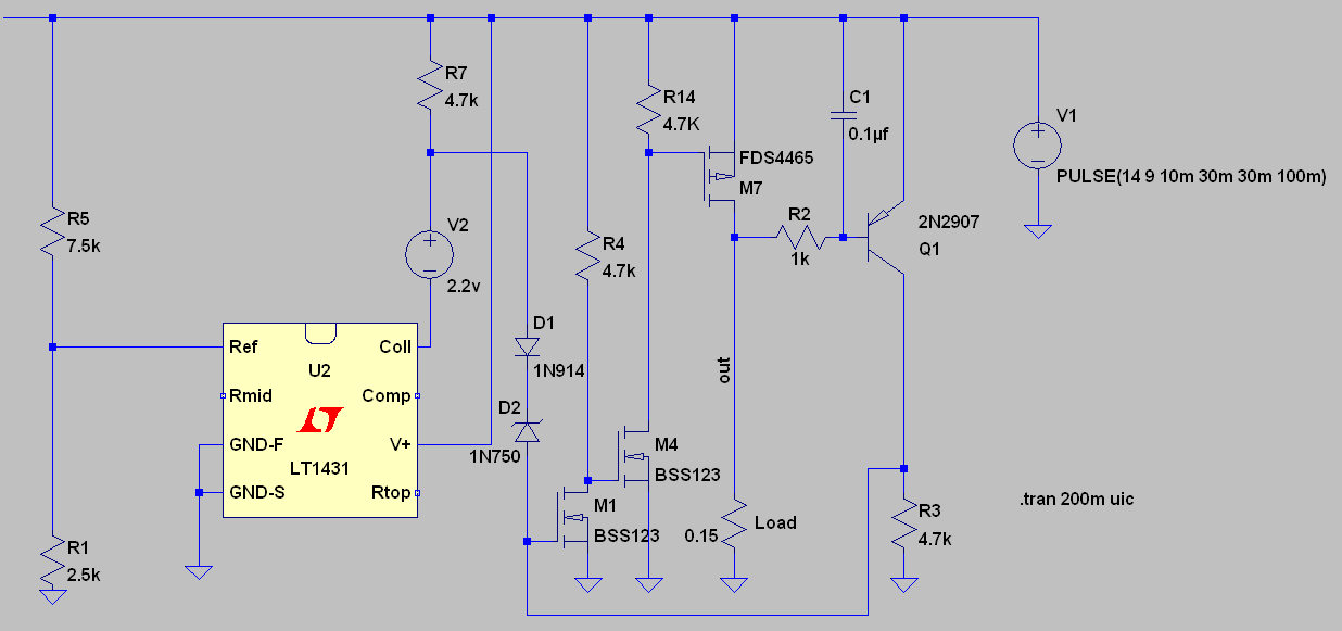

Here is a circuit you might get some ideas from.
I could not find a TL431 so I used a LT1431. V2 makes it work more like a TL431.
R5&R1 will cause M7 to latch open if the battery gets below 9.7V (change R5 to get the voltage you want)
Q1 monitors M7. If the voltage across it gets too big (0.65V) it will cause M7 to latch open. Crude way to monitor current.
I have LOAD set to 0.15ohms. At 0.1 ohms the circuit over currents and latches open. Change the RDSon of M7 to set current limit.
I used the TL431 only. Did not use the op-amp.
Made latch via M1, M4, M7, Q1. Could have made a latch more simple but wanted to add current limit.
Spice file has an error but will run.
Removed battery and added a PULSE voltage source so you can see the voltage drop with time.

The P Fet is IRF4905 55V-74A-20mΩ, and I killed it, the M4 BS170, 60 v 500 ma has survived fine, the power supply is a Lambda 20 v, 8 amp with volt and amp limit, and you caused me to look at something that hit nerve & I lost my concentration for a while, The sim is for use in a vehicle and the .1 ohm is in place of motor that stalls at about 50 amps.
Yes the power supply does drop and that is probably why I killed the P Fet.
As I started working on the board today, a crack in it became a break, so I'm rebuilding it.
The problem, as I see it , is with the SCR having the cathode grounded, although via NFet BS170, it seemed the other devices were tripping it with their normal bias voltage and to combat that, I did what you did, but with a diode, which raised it normal bais voltage to the next device. I ended up using an LED in the gate so the normal bias voltage was well below what it took to turn on the device. Another item is the VGS(th) Gate Threshold Voltage VDS = VGS, ID = 1mA All 0.8 2.1 3 V for the BS170, the Vak of the MCR100 is almost there so I wanted some room for what ever.

It's a end of travel detector and current shut down. As the motor reaches it's end of travel and stalls, the current goes way up, so I set the trip point at a point well below stall and turn off the PFET supplying current to driver, to reset the SCR, the driver must be returned to 0 to turn off the the M3 FET (you're right, my schematic is hard to read)
The LEM is a hall effect current sensor that's modified.
During the rebuilding of my circuit board, making sure every thing was working as I went along, the SCR problem was still there, that is it would trip, but it was resetting itself, the problem was not enough current to hold the latch up, I only had 2ma , testing showed the 13 ma was right on the verge of maybe hold, maybe not, changed the 5k Ω resistor to 470Ω 1\2 watt. It's working reliably now.
