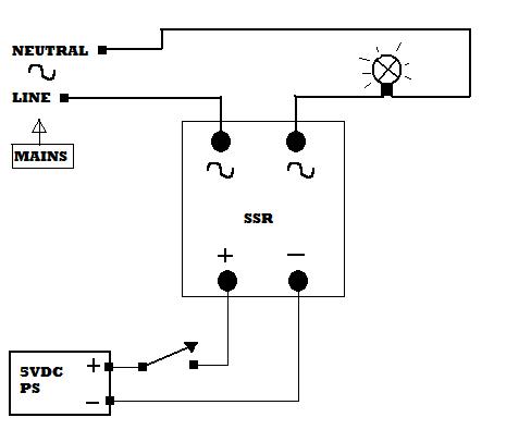

BTW this is my understanding of this circuit. Anything else to add in here?
This is just a cuter version of exactly what I drew (with the exception of 13 VDC vs 5VDC as the signal voltage and I included a switch)
Between these two diagrams, what isn't clear?
One note that isn't trivial. Ensure that the switching (relay) is done on the hot (line) side of the bulb. It is poor engineering practice to switch the neutral side in circuits such as this. This is because when the circuit is de-energized (DC signal switched OFF), if the switch is on the neutral side, line voltage will still be present through the bulb and wiring presenting a dangerous situation if a ground path is presented.
By this you mean i should connect the +ve of Bulb to Terminal 1 or 2 and the -ve of the Bulb to the -ve of the AC cord? Right?

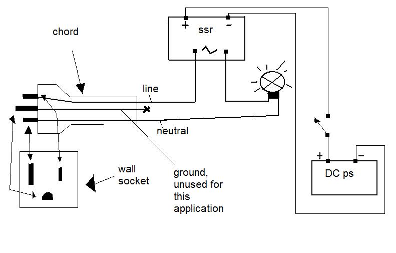

Ok i have updated the pic, it should look like this now
You need a fuse on the wire from the mains outlet to the relay.
That picture of the zig-zag cord is most likely a complete product, a convection heater element of some type. A rather unsafe looking one too.
Perhaps this drawing, including a plug and socket diagram, will help you more safely wire up the relay and learn as you go.
Typically, remember, that the power cord has three wires. Line (hot) is usually black but sometimes red, orange or blue. Neutral is usually white but I have seen grey and on rare occasion brown. Ground is usually green, green/yellow, or uninsulated wire
**IF IN DOUBT DO AN OHM METER CONTINUITY CHECK BETWEEN THE SPADES AND THE ENDS OF THE WIRES TO VERIFY!!**
I advice you to build your project in an enclosure, making sure all AC wiring and connections are insulated from human touch when energized. If the enclosure is metal, THIS IS WHEN YOU SHOULD USE THE GROUND WIRE. Connect the ground wire to the metal enclosure with a screw and eye-crimp connection. This is for safety to provide a path to ground in case electric power shorts to the metal.

This diagram clears all my doubts. BTW that switch at the DC part is to turn it on/Off right? But as i m going to use the Microcontroller, in my case the Arduino which is being controlled through a software and will act as a switch, so i think i dont need that Switch.
Thanks for the Diagram. :), you are of great help.
