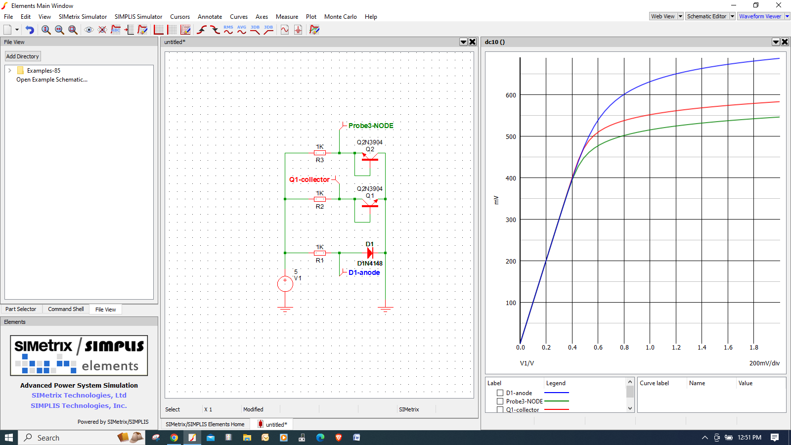

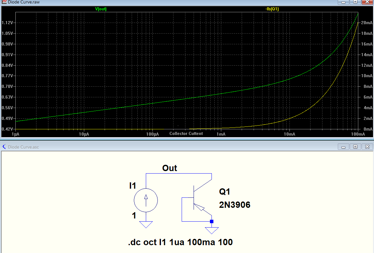

Ltspice simulation comparison below (straight line is ideal with the log current scale):
If you need more than 5V reverse breakdown, you can use the collector-emitter junction with the base-emitter tied together.
That will give nearly as ideal a curve as connecting the base-emitter, but will have the breakdown voltage of the transistor collector-base junction (40V for the 2N3906).

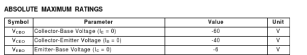

From the STMicroelectronics data sheet for a 2N3906:
The VCES rating is usually equal to the VCBO rating, so this configuration should work as a diode at up to 60V reverse bias.

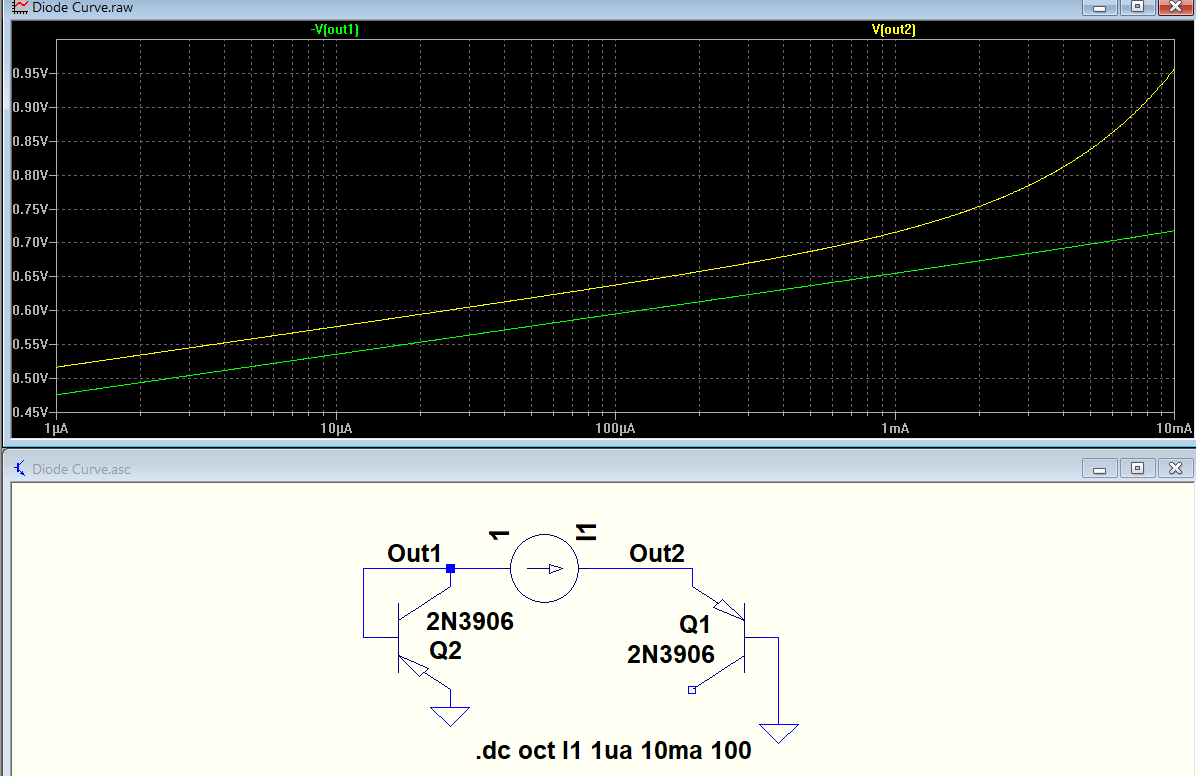

Below is the sim for using the collector-base junction as a diode.
Connecting the base to the emitter adds the transistor's reverse current gain (which, of course, is much lower than the forward gain) to reduce the current through the higher resistance base terminal (yellow trace), and thus reduce the forward resistance at the higher current level.
The diode characteristic (green trace) is fairly ideal (straight) up to about 10mA, where the internal resistance causes it to curve upward.

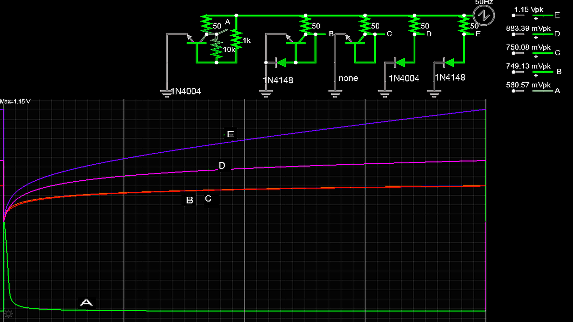

When a 1N4148 drives the base, the collector amplifies the shared voltage and current. Using this method not only makes the diode more ideal but lowers the ESR*Ron=T time constant.

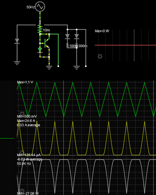

The observant will see two diodes in parallel with non-ideal Rs added that are mismatched and result in 50% Pd difference and temperature difference depends on coupling of Rjc-Rjc.
Proof : https://tinyurl.com/2komn5kw using 1N4148 for Base and 1A diodes (1N4004) elsewhere to compare using interactive switch https://tinyurl.com/2q9cw4bk
1st link has a default 5A diode on far left only. Realize this does not include thermal response and would burn out so I lowered the ideal voltage source here (theoretical)
Conclusion the better diode response uses a transistor to lower the incremental resistance of the external diode by hFE @ 1V.
(sorry for rushed answer)
