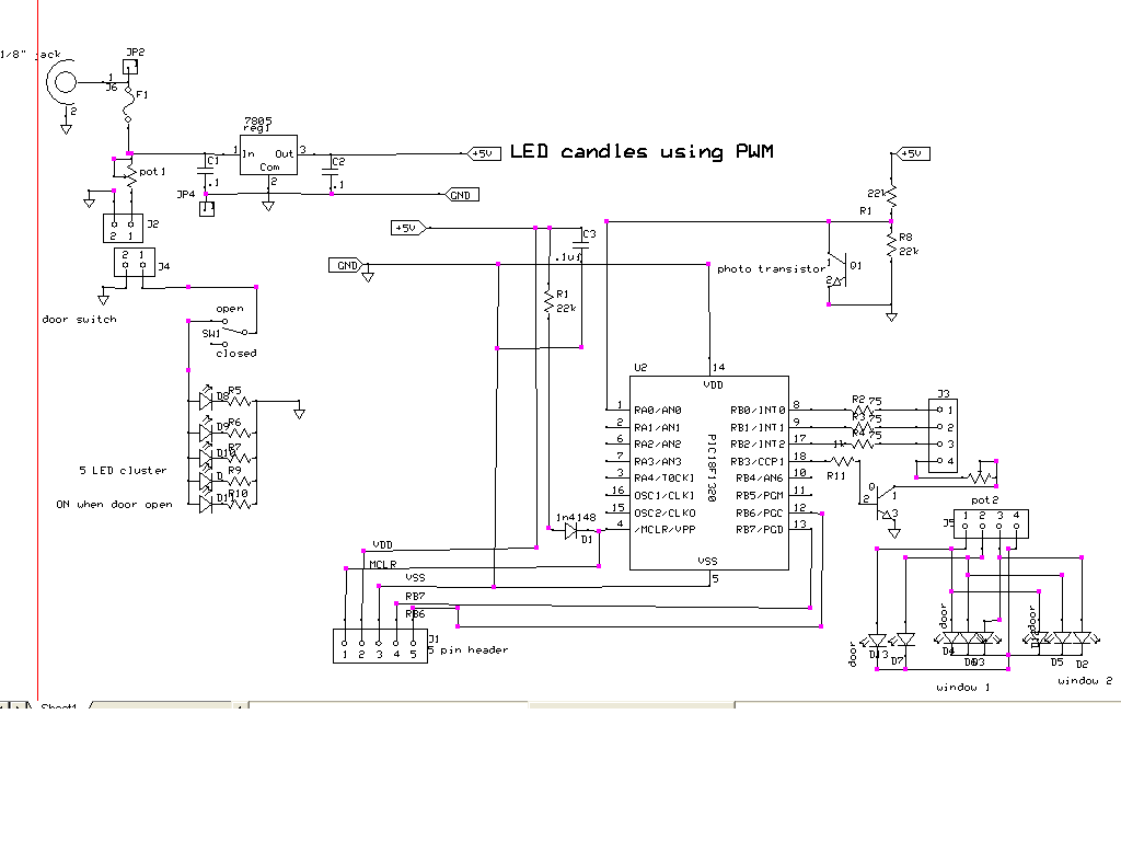

using the CCP1 output/input pin 18 on an 18F1320
MrDEB
need to enable 3 outputs determined by a phototransistor Q1 and figure that the ccp1 pin 18 on an 18F1320 would do the deed unless a better method.
the photo transistor measures .03Meg with ligh and .800+Meg in dark
gots to be a better method?? and how to use the compare function or would ADC be better?
I have a sample of what would work but I'm just getting my shop back and running been a long road home.

My proposed schematic
With light I get ,8v without light I get 2.++ volts
BUT it dosn't look right? not electrically sound but ???
Don't know if I could just ENABLE the B ports and eliminate the transistor?
Are you just trying to detect light and dark? If so, I was able to do something like that just using a plain vanilla LED. If you're interested I will look for my notes... I think it was just a matter of charging it up and then switching to an input and measuring the discharge time (which is affected my the amount of light on the LED)...
Mike
I am detecting light and dark in a room. The room may be dark for several days so a discharging circuit may not work
This is similar to a CDS / voltage comparator circuit in that it performs the same task.
In darl condition, the window LEDs are ON using PWM.
In daylight, the window LEDs are OFF.
All this is controlled using a PIC (see schematic)
Well it's not a "discharging circuit" but rather a method that charges the diodes PN junction by reverse biasing the diode and then counting how long it takes for that junction to discharge. If interested, here's a thread that you might check out LED as Ambient Light Sensor & Indicator.
Regards, Mike
This is a pretty cool idea. I think I remember Forrest Mims talking about this in one of his books, using different color LEDs on satellites to measure tree density.
I may need to rewrite the ADC code slightly as I can't get the LED connected to port B0 to turn on. I need to add an >= formula but running out of time.
Still need to either etch a pc board or hard wire circuit. Contemplating taking the easy route and use a 741 op amp comparator circuit (easy way out. Yea I know it sounds like I am giving up but ???

MeDeb the result is a lot more then 1 if the photo transistor is on it's a 10 bit number so you want to compare it to a lager number
like
If result > 128 Then
   high (LED0)
Endif
 wend
If you just compared to 1 it would never go off I think it's right justified in the module so
you could say 0 volts is 0 and full on is 256

warning warning! Will Robinson!
changed as per suggestion but I get a warning

I tried changing the ADC.READ(0) TO ADC.read(1)
still not working.
Bt adjusting VR1 (RA1) it should out an analoge signal to convert??

Copied and pasted. Just need to program little Junie and give it a whirl
sure glad Toyota didn't make the Junebug or it might run away
my bad but still doesn't work
Needed to turn vr1 and vr2 on using the dip switches.
am still wondering if the charliplexing is fouling this up.

Here is my testing schematic
I just may use this to insert into the project.
Using this to eliminate ANY chariplexing issues or other ??
