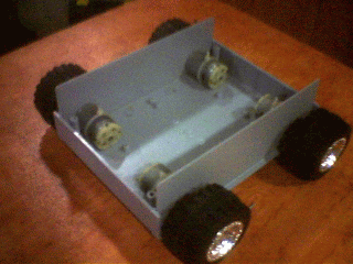

My project is a telemetry system which need two RF transmitters and two RF receivers
I have a car which carry three sensors and I need to send the data from the car to the base board to view the data on lcd display
In the same time I need to control the car from the base board
Every thing is OK but I do not know how to deal with the RF modules
How to make one receiver to be effected form one transmitter?
Any one could help me doing that?
This is a picture for my car before several modifications
