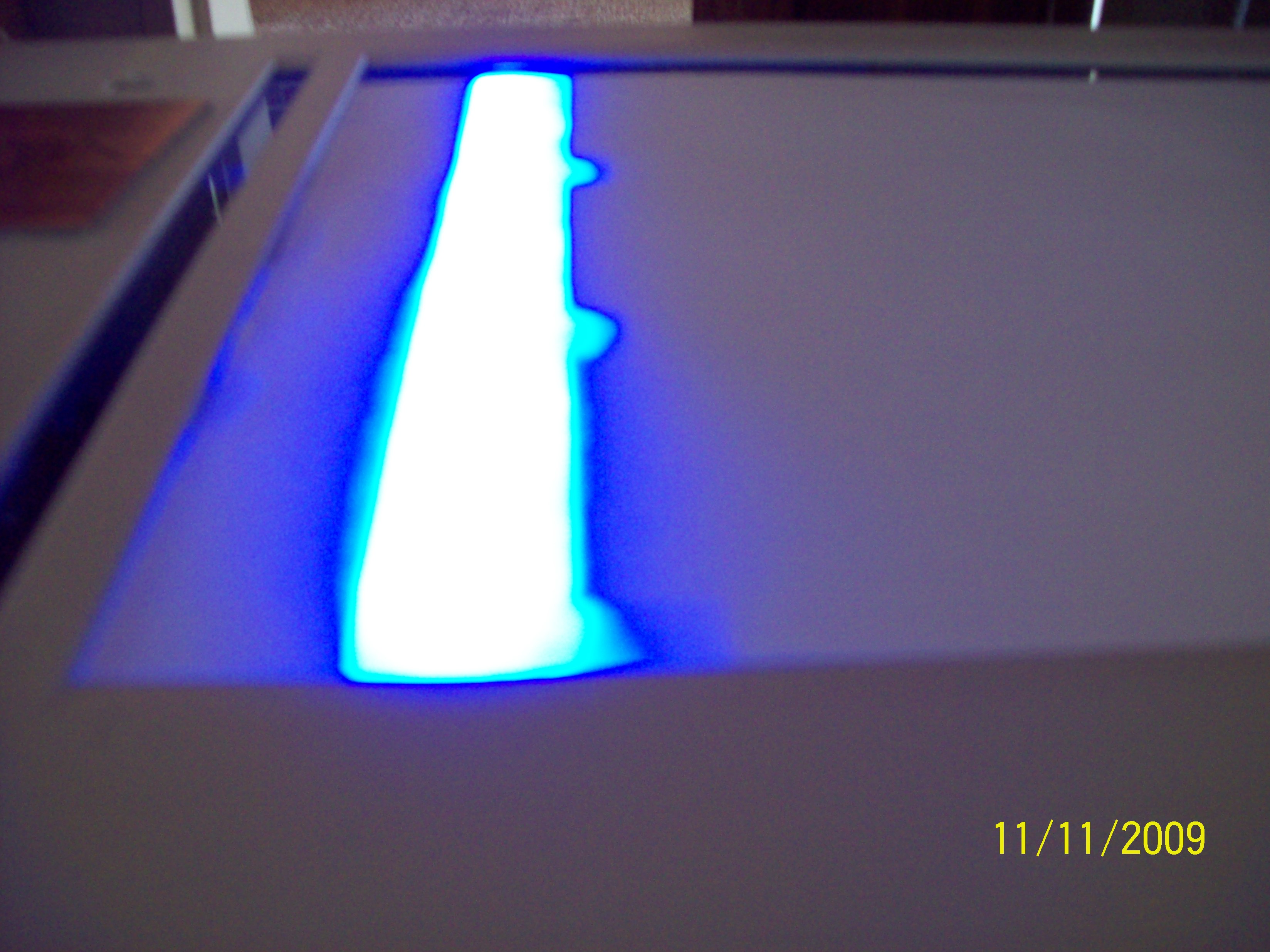

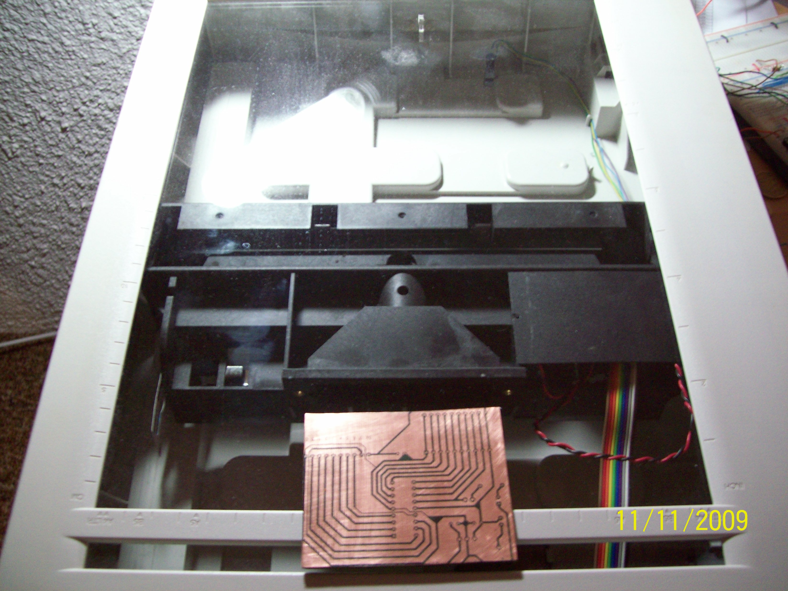

I am building the above from an old discarded flatbed scanner and have most of it working. It comprises about 36 leds in a row which replaces the flourescent that was in the scanner. The motor is now driven by a 16F628 pic. All works well but I would like to know what I could use for shielding as, when the leds are on, I am unable to stand near the scanner without becoming nauseus. I think it's from the uv radiation being produced and would like to make the box safer.
Any suggestions welcome.

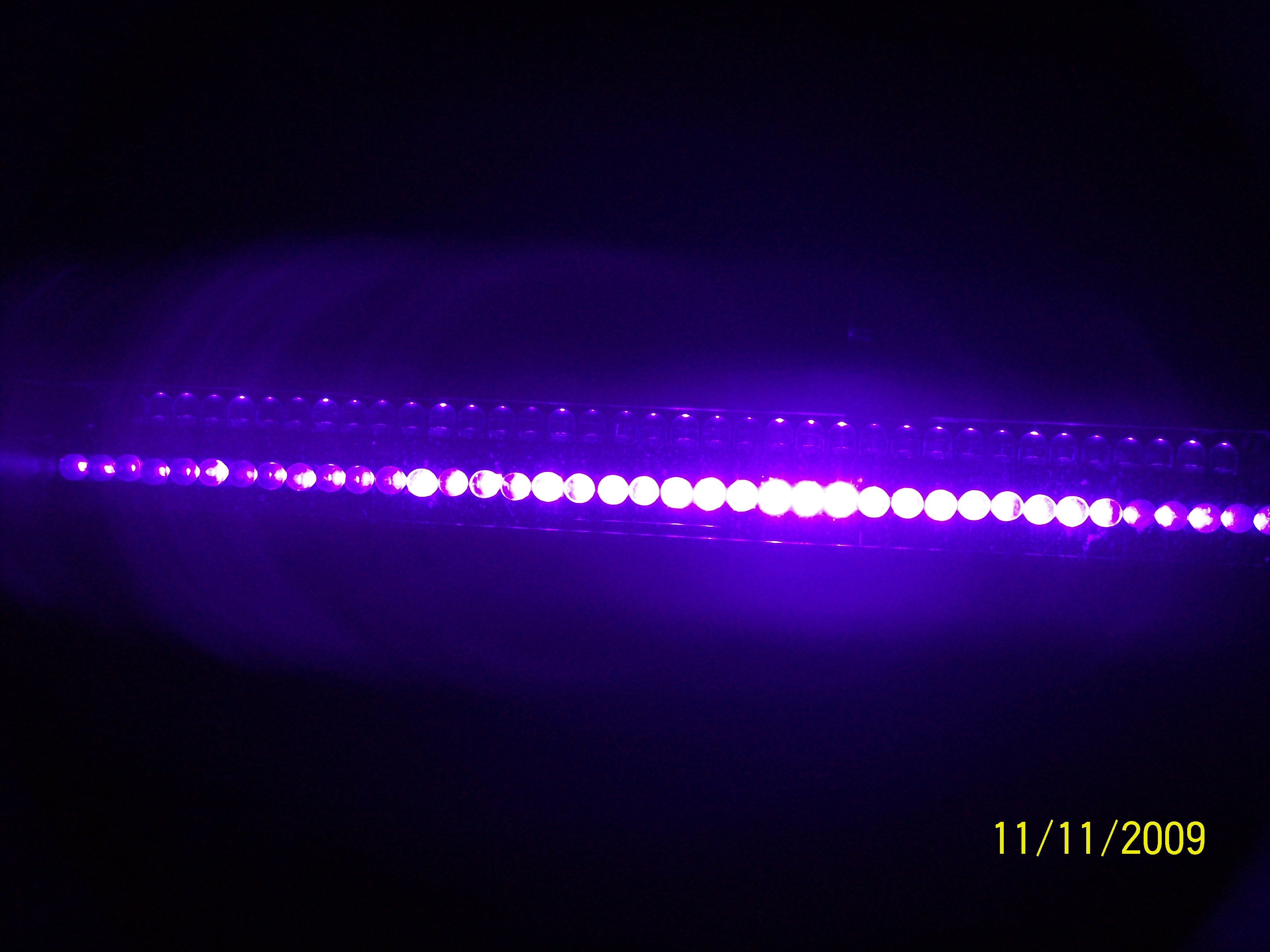

can you actally see the UV light from the leds??
Hi cobra1,
Yes, see attached pics. UV works through glass.

You might want to put some kind of diffuser on it to avoid bright/dim spots, the brightness loss isn't too much of an issue as you can just let it stay under it longer. We can't see the UV but we can see the portion of it that extends into the upper Violet range, the primary frequency it puts out is invisible to the human eye. If you put a UV light next to something that fluoresces under UV light you'll notice how much brighter it is than the apparent UV source, and that's a secondary reaction.
Cobra, I'm not sure why you think UV is so limited, it's nothing more than a colour of light that's just outside our visual range, birds have been shown to be sensitive to UV light, and can see interference patterns in the day sky cause by UV light diffraction patterns as part of their geolocation systems. That's UVA though, you may be thinking UVB or farther up the UV spectrum, down actually as it goes clear on down to 10nm's. UVA is only 400-320nm
Hi Magen,
I wonder where you left the original lid of the scanner. Exposing PCB material the lid should be used to avoid UV-light causing (most probably severe) eye damage. Put some extra weight on the lid to have it press the film and the PCB well on the glass.
If you want to learn more about the abilities of UV-light contact the sales manager of Seoul semiconductors. He lost vision of one eye completely looking at an UV-LED radiating at 340nm (UV-A) and a forward current of 100mA.
Boncuk
One of the reasons I suggested a diffuser. Something as simple as a thin sheet of tissue paper will diffuse the light very well. Again power isn't the issue, the frequency of the light is what's supposed to do the work.

I do have the cover for the scanner and use it whenever I use the scanner.You cannot see anything when the lid is closed. What bothers me is what UV I cannot see. There isn't really a problem with diffusion. I think the pic I took is misleading.See attached. I placed the led's as far down as I could so the coverage ended up pretty good. I still busy with the circuit so I think I'll add a beeper and led to indicate when the led's are on and keep away from them.

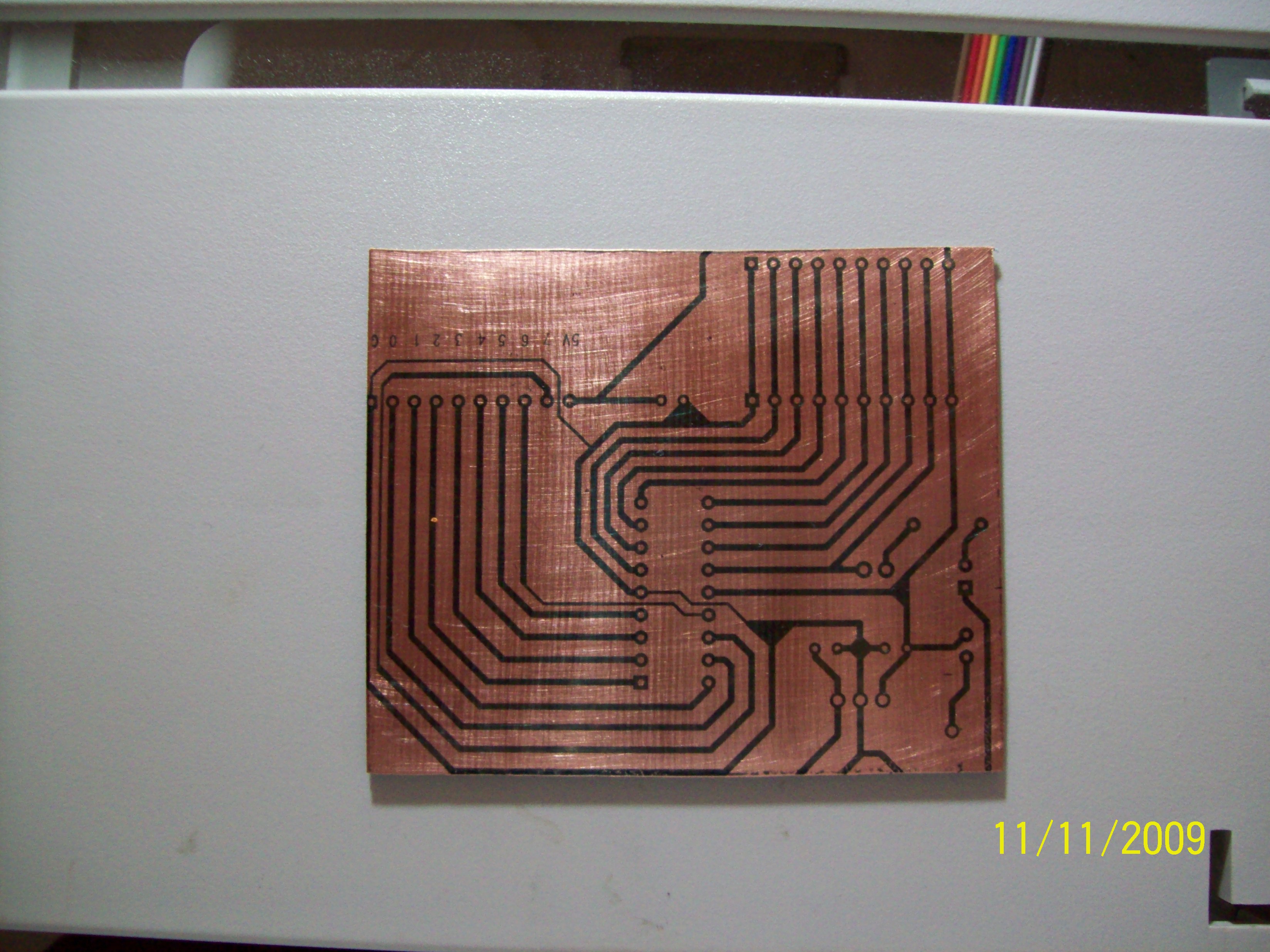

I use it to manufacture pcbs at home. Using the scanner like I am saves me buying more leds to cover the larger area, plus I'm learning to use microcontrollers so it's a nice 'beginners project' for me.:)

You can't beat the quality of an UV-exposed PCB compared with toner transfer.
It is next to a Gerber photoplot.
If you want top quality for a "film" use positive UV sensitive film and make a contact copy of the original laser print from the transparency of a PCB layout. The positive film fills all "blind" spots being produced by the laser printer.
I used that method using negative sensitive film for double sided PCBs with plated throughholes and differential etching.
