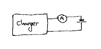

use A-meter in series with bateries to see current charger

The voltage is irrelevent (as long as it's far enough higher than the batteries), you charge the batteries with current not voltage, niq_ro showed how to connect an ampmeter above.

To answer your question about digital readings. If you put a digital voltmeter across the output terminals you will be able to adjust to a precision voltage. However the voltage will change as the output voltage is not regulated. P2 adjusts the voltage out. But each different load will cause a different output voltage. You can put a digital current meter inseries with the load and adjust P1, as it adjusts the output current limit.
