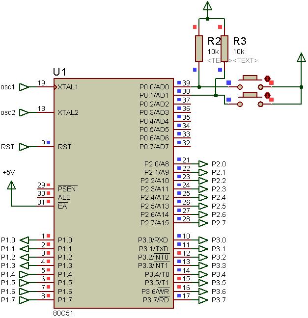

Hi, I am using the 8051 to create a delay function with a variable (in this case BPMtime). At first the BPMtime variable is set to 100 and when i push and release the switch (on P0.0), the BPMtime becomes 101 hence the delay is increased. The same goes for the switch on P0.1 but instead of incrementing by one, i would like it to be decremented by one.
To know if it is working correctly, I outputted BPMtime to port 3 to see if the value is changed whenever i press one of the buttons. So far for some reason the program isn't working correctly. When one of the switches is pushed, the BPMtime stays 100. P0 doesn't have internal pull ups. The program is compiling successfully.
The program so far:

Thanks for your time.

P0^0 and P0^1 refer to pins P0.0 and P0.1 respectively. i didnt exactly understood your reply. thanks

Ok! Then P0 = 0xff, not P0 = 0 you need P0 to be an input port!
yes that was a mistake. i edit the program and put it in my first post. but still no luck with it working. Port 3 is still isplaying "100" (in binary of course)
ItsMike, I have declared them as volatile also but the program worked the same as it was...
