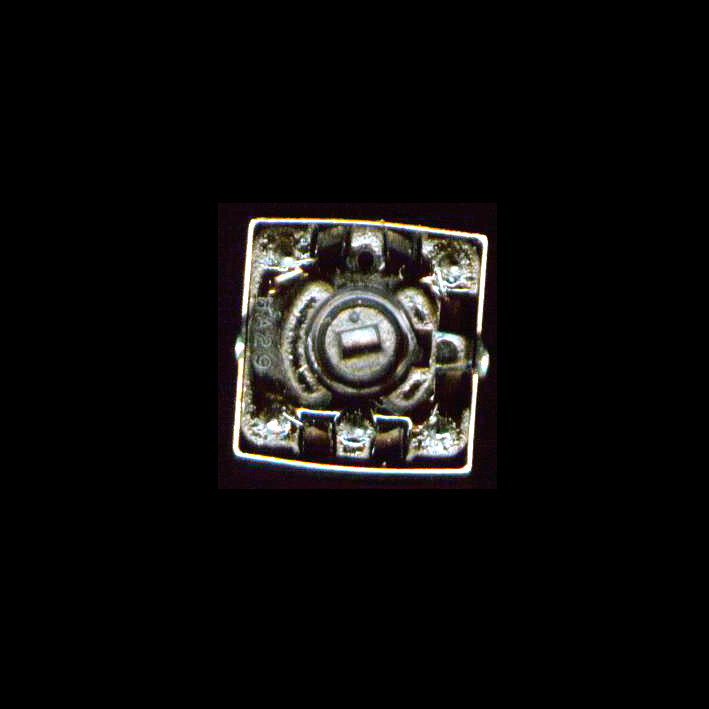

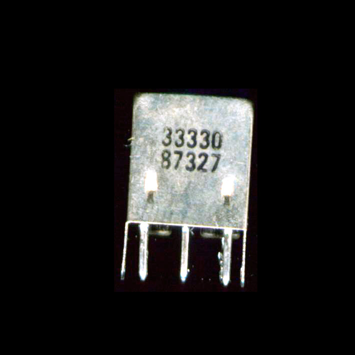

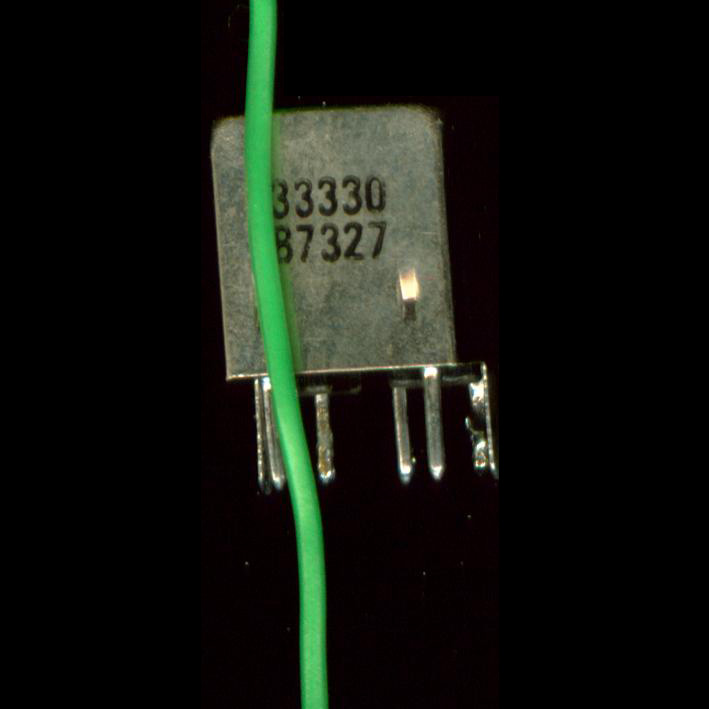

Hi Forever99482,
The pin 5 mystery is only a typo that probably sneeked in because
pin 6 of the KANK3333R is connected to pin 5 of the TCA440.
As with most Toko 10K coils pin 5 is missing, so it can't be connected
to pin 5 ! The general rule is if it isn't necessary pin 5 is always
missing, the same goes for KANK3334R, KANK3335R and a lot of other
Toko coils.
on1aag.
